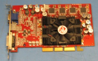

    20.82 KiB
    6767 views
    An evil Radeon 9500 Pro 128MB - don't want this one.

That one pictured is a 9500 Pro. The non-Pro has two chips across the top and two down the back like a 9700 except for the 64mb version which has two across the top and two empty pads down the back for the two missing memory chips.
Originally the 9500 non-Pro was created so ATi could make use of their binned 9700 chips with defective pipes. When demand exceeded the supply of binned chips, they started using fully functional 9700 cores with 4 cores locked, so some do unlock and some artifact to varying degrees when you try to unlock them depending on how badly damaged the core is. I do not think this was ever the case with the Pro version of the card as they were never unlockable but they used a crippled memory controller to keep it from competing too directly with the 9700. ATi went through the same thing with the 9800 SE being unlockable to a full 9800 and the X800GTO2 being unlockable to a X850 XT. I think they started laser cutting their cores after that.
