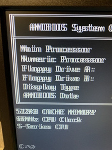

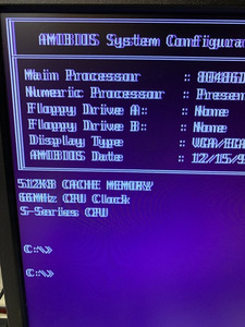

I got an affordable TLC34075-135AFN TI PLCC-84 off ebay. It was easy enough to align and insert. When I remove J6, HWinfo says the the card has a ATI688875 ramdac and it does the high refresh rates, but ...
The picture is a strange double image, sometimes tinted purple. The palette on games like doom is unpredictable. Sometimes almost correct. Other times lots of pinks and other junk. At higher resolutions, the colors are shifted differently. Messed around with the utilities and couldn't find anything to fix it. I have a 1993-5-20 bios on my card, which is on the newer side. My card is ATI MACH32 VLB, P/N 113-19509-100 according to the BIOS dump.

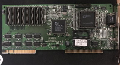

Thanks for the reply, I'm just starting out with this machine. I'll get a full idea what sort of Mach32 I've got though it looks like (from the BIOS at bootup) it's P/N 113-19500-100.
*Edit* chip shot attached.

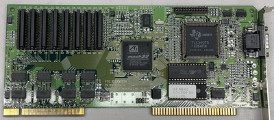

Reply 35 of 44, by douglar
Kar wrote on 2020-10-27, 16:11:
Looks like you got the ramdac but only 1 DIP 28 chip there.
P/N 113-19500-100 = EXM195 = Graphics Ultra Pro yes?
Mine is EXM195a. Here's a pick with ram upgrade and not really compatible ramdac.
Looks like mine has an EEPROM that let's me save refresh rates, etc. Does yours do that?

Reply 36 of 44, by Kar
Sorry for the delayed reply here - that second dip socket (the one you have, and mine is missing) is the original RAMDAC. You've put your new one in there, so you could try removing it and see if that stops the strange behaviour?
A full shot of my card is attached, note my empty socket above the bios and below the full ramdac.
Reply 37 of 44, by douglar
Kar wrote on 2020-11-05, 18:12:
Thanks for the photo. any idea what that empty socket is for?
My strange video behavior goes away if I short jumper J6, which disabled the external ramdac and enabled the onboard ramdac. I verified this using HWInfo. When J6 is shorted, it is using the slower on chip 80mhz 68830 ramdac.
I installed a TLC34076-135FN TI PLCC-84 to see if that made a difference, but I got the same behavior.
http://ps-2.kev009.com/ohlandl/video/ATI_GUP.html
RAMDAC Older boards use an ATI 68875 CFN, newer ones use a TI TLC 34076-135FN. The TI chip responds as an ATI 68875 under the install program and other diagnostic applications
He was right though. Both chips report themselves as a ATI 68875 CFN under HWinfo.
Seems like I need to track down an honest to goodness 68875 ramdac to make this work.
