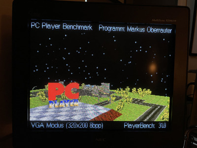

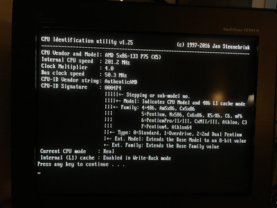

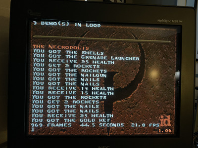

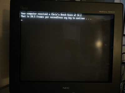

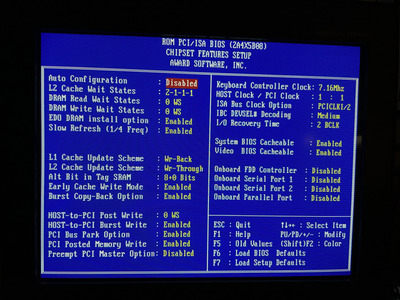

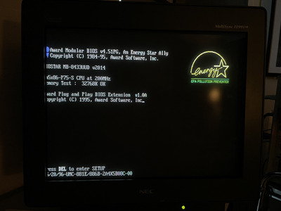

Reply 625 of 753, by Chadti99

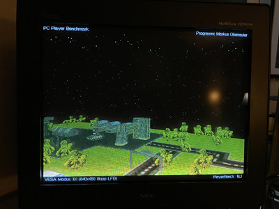

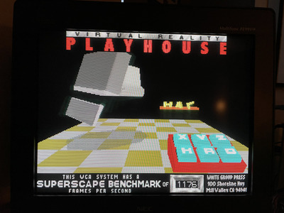

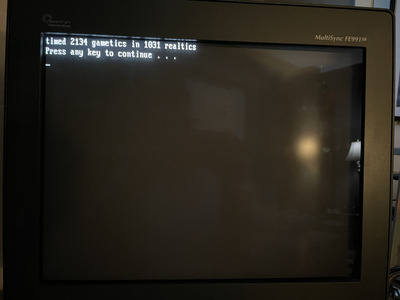

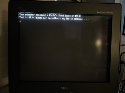

Okay I know I've been all over the place providing results but here are my results with an air cooled AMD5x86 at 200Mhz, seemingly 100% stable, at 5 volts. I'd like to perform the full set of tests on the LuckyStar LS-D board I have, and will at some point, as it beats the Biostar in most tests. I really like that the Biostar offers attachment points on the CPU socket for me to secure an oversized cooler and mount vertical in a tower case. A large cooler and thermal paste is required for stability. I'll also add that I've tried this board at 66x3 and it ends up being slower as it requires the slowest cache timings for stability. At 66Mhz, neither 1:1 or 1:2/3 CPU:PCI ratio are stable on this board or any other board I've tried with this CPU on air cooling.
Here is an unedited almost 2 hour long bench and torture session, with me rambling a bit in my native KY twang.
https://youtu.be/6gqgnFn3QZ8. *Still processing High Def
1) Biostar 8433UUD 3.1, 256k 12NS Cache, fastest timings, 50Mhz FSB, 1:1 CPU:PCI
2) AMD 5x86 P75 133 @ 200Mhz (50x4), 5volt, air cooled
3) 32MB EDO 60NS
4) SD2IDE
5) Matrox G200
6) ESS1868
7) no NIC
8 ) DOS6.22 & Windows95
9) Onboard PS/2 mouse port

Reply 628 of 753, by feipoa
Neat, now the UUD at 200 MHz (4x50) matches that of the LSD ta 200 MHz (3x66), that is, they both score 21.8 fps in Quake. Does it run Windows in this configuration? If so, request your trophy from CPU Galaxy.
Reply 629 of 753, by Chadti99
feipoa wrote on 2022-03-16, 14:31:
Yes it installs and runs Windows no problem, you’ll see that it runs Windows in the long boring video if it ever finishes processing. I wasn’t paying attention and recorded in 4k30.
I think it’s likely I could hit 21.9, at stable Windows settings, if I were to test the LS-D board at 66x3 in DOS6.22. It turns out DOS6.22 provides slightly faster results than 7. All my previous results have been in 7 unfortuneatly.
*I see that pshipkov maxed out at 21.8 on the LSD at stable settings, so 21.8 might be it.
