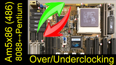

Well, here is my first try 😀 . I got 3 x 64 = 192 MHz. 3.9V stable with perltier.
Unfortunately I am a bit late to the party, and a bit unlucky with my CPUs.
My M/B is also an older revision and does not support EDO ram.
Got some relative good results (I think).
Video:
https://youtu.be/PZ82WlMuG7k
Benchmark results:
https://docs.google.com/spreadsheets/d/1hUfLI … w6Dlv7xmWyDDUFT
PS: I have a month now a custom PCB for 1MB L2 mod. Waiting for chips.

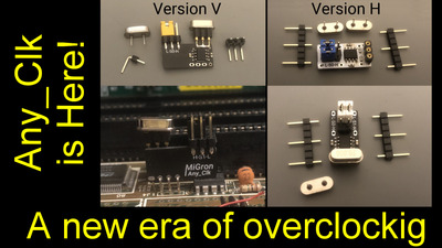

Fantastic results! Where can I learn more about the custom clock generator? Looking forward to updates!
Thank you, Here... 😜
https://youtu.be/odcH80wiiPs

The custom any clock device is interesting. I'd personally like to see a plug-in replacement for DIP-14 PLL's found on many of the socket 3 PCI systems, e.g. UM9515-01. My interests would be to fine tune a Cyrix 5x86-133/4x chip. We know 150 Mhz is too much for it, so some tuning in the 135-145 MHz range would be fun. I recall running into fully programmable PLL's in the past, but never used them. Swapping the MB's crystal that feeds the PLL doesn't work well in this case because it renders other systems inoperable, like the floppy diskette.

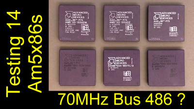

Binning / Testing 14 Am5x86 CPUs. The 190% Overclock on Am486-DX2-66 and the Unreal 70MHz 486 Bus!
Enjoy...
https://youtu.be/dwYBq7K7h-Y

Another great video! I just noticed your 110Mhz OC on a POD83, very cool!
