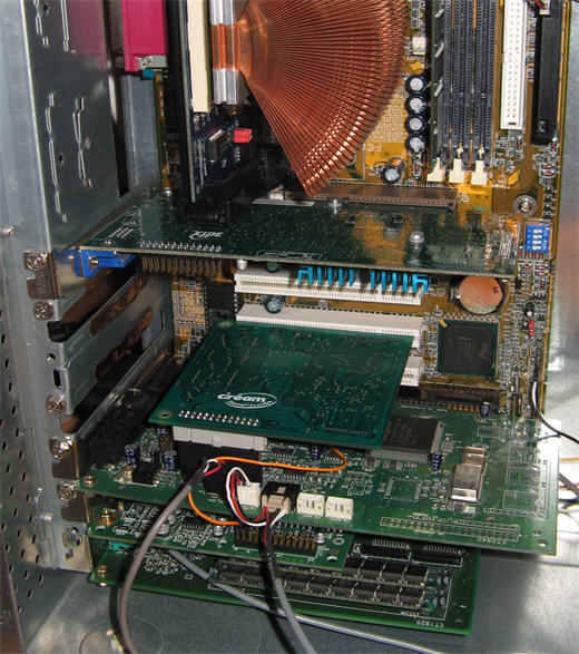

My current sound setup from top to bottom:
-Dream GS wave 4MB Midi DB.
-Stereo reverser bracket for midi DB, Also the midi signal originates from the MPU-401AT through the orange wire.
-SB16 CT2940, with CT2502 Vibra Pro and OPL3-L.
-MPU-401AT: only using midi-out signal, not using the WB header on this one due to clipping of analog midi output when playing loud midi's.
-CT1920 EMU8000 goldfinch card with 8 MB. Just a little extra. I don't initialize it at boot, but manually when I want to use it.

    sound setup

Gerwin, I'm really confused about what you are doing with the MPU401AT. I thought the whole purpose of having it is to avoid the hanging notes problem common to most SB16 cards. I take this to mean you have found that your CT2940 does not have the hanging notes problem? You mentioned that your DB has clipping when connected to MPU401AT. Is this a problem related to your specific DB, or is the MPU401AT defective in some way?
Reply 53 of 61, by TheMAN
he's saying the output clips when using the WB header from that card
this is what clipping means: https://secure.wikimedia.org/wikipedia/en/wik … ing_%28audio%29
The midi Waveblaster header has four functions:
1- Midi data for the DB.
2- Reset signal for the DB.
3- Power supply for the DB (5,12,-12 Volt) and ground.
4- Analog left and right from the DB.
(sometimes Midi data from the DB)
In my setup part 1 is supplied by the MPU401-AT through the orange wire. All midi data goes through that single orange wire. The bugged SB16 midi signal is going nowhere.
Parts 2,3,4 are connected to the SB16. The two signals from 4 are reversed before they go to the SB16 mixer.
I can do this because there is this home made bracket, in between the waveblaster connectors.
IIRC The clipping does not occur when using a Roland DB on the Roland MPU401-AT. But with my favorite DB, it does.
Reply 57 of 61, by Anonymous Coward
This is a very interesting setup. Very ugly, but I like it. Have you had a chance to test the Acer Magic S32 that is similar to the CT2800 you are currently using?
I'll have to pay closer attention to the XR385 board I have connected to an MPU401AT to see if it is clipping or not. Is there any way to rectify the problem? Perhaps by using the RCA outputs rather than the headphone jack, or maybe soldering in a resistor somewhere?
When I encountered the problem I tried other DB hosts cards, but many
gave me clipping. Then I solved it with that orange wire, and left it
like that. It is even preferable to reroute the digital midi signal, compared to
using an analog line from the Roland to the SB16 line-in.
The problem is diagnosed best with the Warcraft II midi files, or the intro
tune from the Shadow Warrior demo.
It is a bit mysterious, Like that time I wanted to make recordings from DB's
attached to a Turtle Beach Santa Cruz: The recordings had clipping with
every DB I tried. I managed to get rid of the clipping by placing resistors in
between. Multiple kOhm IIRC. With the Santa Cruz, the problem was not
there when just listening to the DB's without recording.
