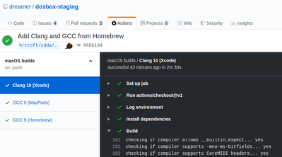

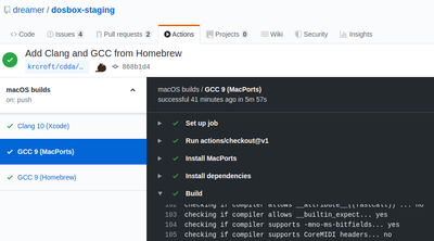

And on OS X, here's how all three compilers behave:
66.26 KiB
1102 views
69.58 KiB
1102 views
72.53 KiB
1102 views
