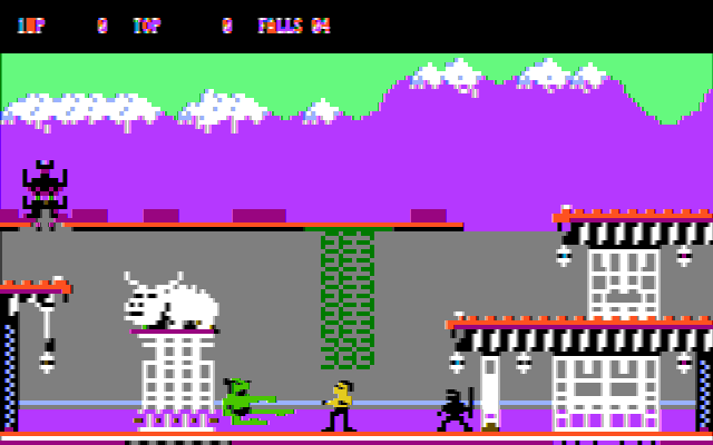

1) The game Bruce Lee has this weird issue with text when the composite option is selected - check out the two screenshots attached:

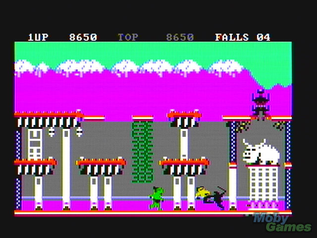

- one is from MobyGames, by a user who apparently captured it from real CGA hardware
- the other is what I get using latest DOSBox - see the differences with the status bar at the top.
The game appears to use the 640x200 mode, but I'm not sure what's happening with the text. Going by the moby screenshot, real CGA shows the characters as double width (40 col) in this mode.
My (uneducated) guess is that it halves the character generator's pixel clock to show the double-width text, but there's probably more to it, since the "TOP" text and score are a different color implying a different bit pattern... whatever it's doing, guess it's something not supported by current CGA emulation?

    Bruce Lee under DOSBox .74

    Bruce Lee screenshot from MobyGames (running on actual hardware, captured from composite output)

the characters on mobyscreen are much larger and thus there is less colour bleed.
but our algorithm introduces always some colour bleed. A more complex algorithm could reduce that somewhat. But I am quite happy with our emulation looks.

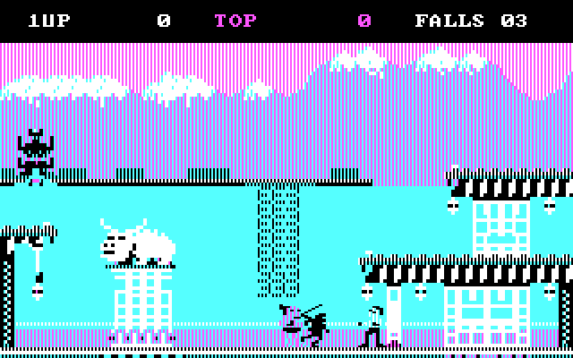

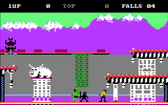

The game was probably designed to use mode 4 (40 column text), and someone hacked it to use mode 6 (80 column text) because DOSBox has full support for composite color in mode 6. They simply changed an 04 byte to 06 and presto: composite color works... but with 80 column text.
Can easily change that 06 byte back to 04:
    3.54 KiB
    1970 views
    With mode 4 and the COMP4 program from the Fooblitzky thread
    1.73 KiB
    1970 views
    With mode 4

Interesting... how come that mode 4 w/COMP4 (especially when using non-white RGB colors) yields the exact same artifact color set as mode 6 does?
Those colors are a pretty good match for the Mobygames screenshot (by Servo), so if that shot is truly representative, then emulation appears correct in this case.
On the other hand, his composite captures of other mode 4 games, with the same palette even, yield very different results (solid bright cyan doesn't translate as grey, for one), so I'm probably just not getting it.

The wall color and thin artifact bands in Servo's screenshots are consistent with mode 6; mode 4 only seems to fit for the font appearance, but not the position as Qbix pointed out. Is there a way to get 40-column text in mode 6?
The game code also supports that composite should use mode 6, as there is code like: "if RGB selected then set mode 4, else set mode 6", which would be pointless if the condition resulted in mode 4 either way. I think the game was originally a booter, and the executable form is a DOS conversion. Could be that the conversion is incorrectly displaying the status line for RGB mode in composite mode... that would make sense. The byte I changed is at offset 0xf224 in the executable if you'd like to experiment.
