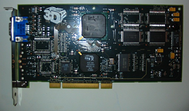

The AGP i740 board stores all textures in "AGP memory" (that's system RAM) and the framebuffer / z-buffer in its local RAM I think.
The PCI version of the card actually implements an AGP bus on the card so that the chip still thinks it has AGP texture memory. There's a bridge chip to convert PCI to AGP for the 740 chip. It's pretty obvious that this card cost a lot more for them to build.
I would think that trying to use an i740 AGP card on Super 7 would be a bad idea because AGP texturing usually doesn't work correctly on those chipsets. VIA actually disabled it entirely in some of their AGP drivers.
In some ways 740 is an IGP on a card. 810 works very similarly. Some 810 mobos have a small amount of separate RAM used as a local z-buffer/framebuffer. Textures are always stored in system RAM AFAIK. And of course later IGPs again always used system RAM.

i740 really uses on board texture memory, frame buffer is limited to 4MB and whatever more the boards have is for textures. As you can see they even use different memory type for each. Just found out there was even 24MB version which had 8 MB framebuffer, they were not adding memory just for kicks.

i740 AGP usually has only 8mb memory on board and does use sideband memory over the AGP bus so it's very slow when fetching textures that are outside of the onboard memory. If you get the PCI version, (very hard to find), then it needs to have more memory onboard because it no longer has access to system memory through AGP. The PCI version is allegedly much faster than the AGP version because it never has to fetch textures from main memory. It's actually faster to swap textures in and out of a smaller amount of onboard memory than it is to have all your unused textures stored in sideband memory. That's the main reason why the i740 AGP was so much slower than other accelerators, even ones that were on the PCI bus because texture swapping over AGP extracts a bigger performance penalty than swapping with onboard memory. Once video cards started selling with enough memory, storing textures in main memory became less and less practical. Video cards that have little or no dedicated memory of their own and rely heavily on system RAM aren't called "vampire video" for nothing.

But it is wrong. Sideband is extra adressing channel reducing latency of agp texturing. It is a performance enhancer, just like whole agp texturing. i740 like all the other cards with agp texturing prioritize onboard memory over main memory. You could argue supporting it is a waste of silicon, but you cannot say it hurts the performance.

Putas are you saying that i740 behaves like every other card and uses its local RAM for everything before using AGP texturing?
I recall Matrox G200 being advertised as designed for AGP texturing as well, having AGP DiME and sideband before the competition.
But if you look up i740 AGP it is hard to judge if people are saying that i740 uses only AGP texture memory of it if just uses it better than the rest.

How can a PCI card use AGP texturing? It would have to be plugged into an AGP slot to do that. PCI slots can't do it. The PCI i740 uses a bridge chip to make it electrically compatible to a PCI slot but it still can't implement AGP sidebanding through the PCI slot so the PCI version has to use onboard memory and have more of it.
Here's a quote from the Wiki entry on AGP
"Intel's i740 was explicitly designed to exploit the new AGP feature set. In fact it was designed to texture only from AGP memory, making PCI versions of the board difficult to implement (local board RAM had to emulate AGP memory.)"
So you had to have more memory on board the PCI version in order to emulate AGP sidebanding because the card can't access system memory from a PCI slot. The bridge chip has to use onboard memory for sidebanding, which means more of it is needed than the AGP version.
