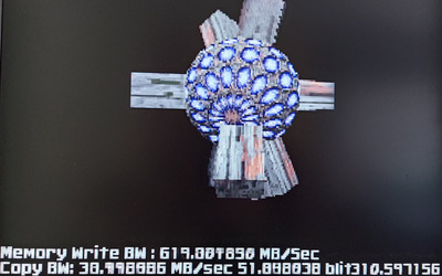

Got my hands on "Generic" Virge DX, decided to test and give my thoughts/hopefully helpful hints.
Actually it runs OK-ish with few tweaks on my P3-933Mhz/Asus P3b-f rig. Yes textures look low res, but it is in line with typical mid 90-ies 3D game look.
I at least couldn't find any footage with FPS counter on screen on YT so I took my own crappy mobile off the screen one: https://www.youtube.com/watch?v=RxACmeoUnWA
It's hovering between 30 - 15 FPS mainly, but I have to admit controls doesn't feel like it's 15FPS. Very playable.
Recommendations:
1) Turn sky textures OFF - will increase performance
2) Pick Menu->Graphics Options ->Poly: Perspect - it will fix rather ugly texture morphing
3) I had trouble finding Virge DX version wrapper. For those who struggle like me files can be found here: https://ctrl-alt-rees.com/2020-12-06-s3-virge … -downloads.html
One more thing - game has build in bench tool with few performance stats. While in Main Menu press Ctrl-Z. It indeed runs slower in S3 3D mode. In S33D mode first line "Memory write BW" clocked only 428 MB/sec compared to regular 2D software mode as seen on attached screenshot below.
I tried to emulate slower PC by disabling P3 L1 cache with hope that perhaps on slower machine Virge will act as 3D accelerator - no it did not. In both modes it run aprox 3-4 FPS.
Also even in 2D mode S3 Virge is slower (45fps) than for example my regular Geforce3 Ti200 (fully maxed out 60FPS). Although GF3 is AGP card so it's unfair to compare.
Last but not least in other news - new remastered version seems to be coming up soon: https://www.gog.com/news/coming_soon_btermina … oosted_editionb
Update: Played around with MCLK tool in DOS today. Well it looks like I got hit by shitty end of silicon lottery. My Virge DX cant go over 56Mhz without getting dos text scrambled...
