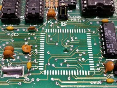

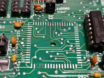

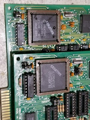

Reply 406 of 468, by goodtofufriday
In seeing how to get rev4 and up models working Ive socketed the chip and will swap them out to see what happens. As I figured the pinout continues to be the same across both board revisions.

Reply 411 of 468, by keropi
It seems someone found how to make the GAL code universal and now works with both CT1336 and CT1336A controllers: https://www.ebay.ie/itm/283320542833
Makes sense to me , there are many CT1336A cards out there with factory pre-installed sockets, they would ditch them to save some pennies if the upgrade was not working... maybe CL sold a specific upgrade for these that is now lost... or planned to sell and did not bother.
I bought this upgrade for a SB2.0 I got with a system ~1 month ago - I was bummed it had the CT1336A controller but now it seems all is well again 🤣 🤣 🤣
Will report back when I receive the new upgrade 😀
Reply 412 of 468, by keropi
Today I tested suntac's new cms gals, they work fine with both CT1336 and CT1336A controllers.
I even replaced the GAL on my CT1336 card 🤣
Excellent work suntac!
Reply 414 of 468, by keropi
Yes, CT1336 or CT1336A controllers no longer matter - CMS will work with any of them 😀
