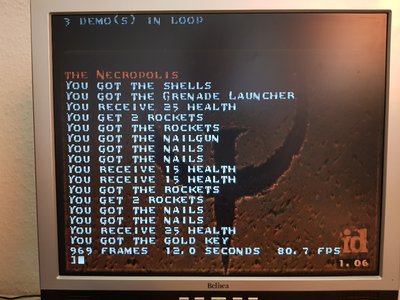

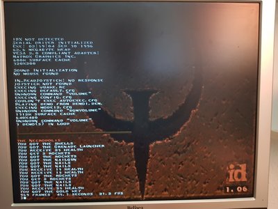

Ok guys, another one.
This time: 112MHz x 3.5 => 392MHz
Quake Timedemo over 80fps, even with 640x480 over 20fps!
Board is a FIC VA503+ this time - only board i had on hand with >100MHz
248.63 KiB
1055 views
245.95 KiB
1055 views
228.54 KiB
1055 views

Is this a 266mhz oc to 392, right?
Reply 159 of 505, by feipoa
I wonder if the chip is long term stable at 350 MHz. That would make for a desirable setup.
EDIT: I predict a 430TX board, if it will work with this chip, will score about 20.x FPS in software Quake at 640x480 when run at 83.3x3.5, or 292 MHz.
