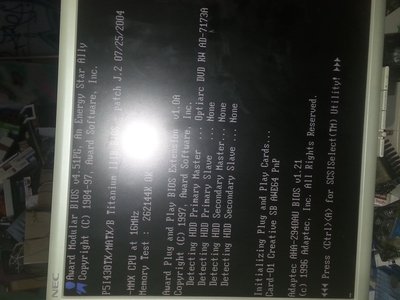

Titanium iiib confirmed working with tillamook and it is a 430tx board!

Reply 206 of 505, by feipoa
Which mods were required and what freq. is it being run at? Did you run speedsys and quake? Could you provide the chart?
Reply 207 of 505, by amijim
This is a stock tillamook.running perfectly on 430tx mobo like a pentium 233 mmx without l2.I will do the mods and postvpics mid oct.I have posted pics in page 7. Thank you.

I got a Tillamook266 work nicely on my QDI Titanium IB (430TX) with L2, I did the mods all at once after seeing if it works as is. As is it ran but L2 didn't work as expected and CPU followed multipiler set by the mobo. With the mods I got locked 4x multiplier and working L2 cache.
http://www.tmeeco.eu/BitShit/PCschit/Tillamook0.jpg
http://www.tmeeco.eu/BitShit/PCschit/Tillamook1.jpg
The mobo misrepresents speed and FSB, but reality definitely is 75MHz and not 40MHz 🤣. I also hacked the board to do 83MHz but the machine froze when it came to actually booting, but was worth to try.
Now I have to mod the mobo itself as it is overvolting the core quite a bit (3.3V), stupid softmenu 🤣.
Reply 210 of 505, by feipoa
Oh nice indeed! Did you look for undocumented Vcore settings? My Biostar 430TX board had a lot of undocumented Vcore options, even as low as 2.1 V. 83 MHz works reliably on my board if I use 72-pin SIMMs. Did you try a single stick of FPM, say, only 32 MB?
Reply 211 of 505, by Tiido
I looked up datasheets of the PLL and voltage regulator and got an idea what they can do. The rest is just cutting the tracks leading to those pins and overriding them with my own settings. The power regulator on the board I got goes from 2.1V to 3.5V in 0.1V increments. BIOS tries to detect a CPU and then allows some range to be used rather than all of it. If the BIOSes weren't compressed etc. it wouldn't take too much effort to just allow all the settings to be used regardless of CPU type. So for the time being I just override things in hardware.
