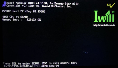

BAD NEWS II: today I got another (2-nd) P-MMX-Tillamook, for the 2-nd socket.
No luck: in the POST there is shown "i(unknown)", and that's all. The same result using one or two Tillamook(s).
For instance, I used another two Pentiums P54C (without MMX) -> the POST results in "Intel(P54C)x2".
As I already wrote, the system is still not tested with any OS (I was simply researching the hardware-opportunities in advance)
So, for me, this mainboard does NOT:
1. recognise the Tillamook-core correctly, and
2. work fine with two Tillamook-cores together (as assumed in other threads, the Tillamook-core is maybe not SMP-able by itself)
So, for my point of view, I will no longer try to adopt two Tillamook-CPUs onto this board. Sorry - simply no chance... 🙁

Don’t worry that it doesn’t know what it is it just means that the code that the cpu is sending isn’t something the bios has in it’s database.
Here is my k6 3 on a motherboard that prettymuch runs fine on it. Just doesn’t say the name and speed right. It’s actually running at 450mhz but bios is just confused on speed and name report. It doesn’t hurt anything.
Continue with tests as long as you think voltage is proper.
There are a lot of people who will be building a dual tillamook if you can succeed including myself. The second you tell me that you got two graphs in task manager I’m ordering another one.

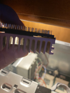

Did some jumpers
Decided to do em fashionable 🤣. Try to keep em lookin pretty.
I got the 512k on motherboard cache working but the 4x doesn’t seem to be working. What do I have to set the motherboard multiplier at? Should I put more jumpers in?

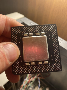

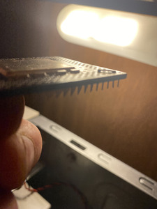

Reply 333 of 505, by Sphere478
More pics

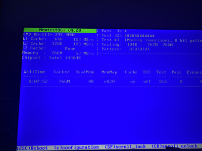

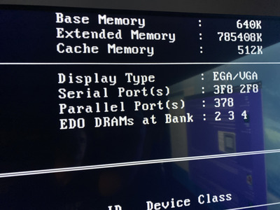

Reply 334 of 505, by majestyk
Hey, that´s 768 MB of RAM! Without using Bank 0?? Or did you put FP-RAM in Bank 0?
So the BIOS handles more than 512 MB, would be interesting what the HX northbridge does under some OS. It would use just 512 MB of it I´m afraid.

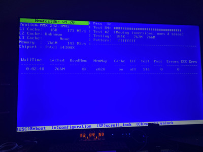

Re: Dual CPU Socket 5/7 Boards more info
majestyk wrote on 2021-02-03, 07:39:
it seems these chipsets, the 430tx and 430hx say they can only do 256mb, and 512mb but in reality it seems with the right ram modules you can actually do 1.5x that. It works best with bank 0 unpopulated on my tyan tomcat if I put 8 x 128mb simm sticks in it it won’t post. But works fine on 768 with bank 0 open.
Memtest sees all the ram🤷‍♂️
I’ve run it a while now with 768, seems stable on the hx but it only seems to work with bank 0 open.
edit: ended up that 768 while it did pass mem test was not stable and only a glitch max ram on 430hx is indeed 512mb though you can get 768 to detect it simply does not work other than in memtest which isn't detecting the problem. i've beat the issue to death and there appears to simply be no way to make it work. save your self the trouble and stick to 512mb
