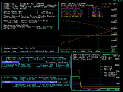

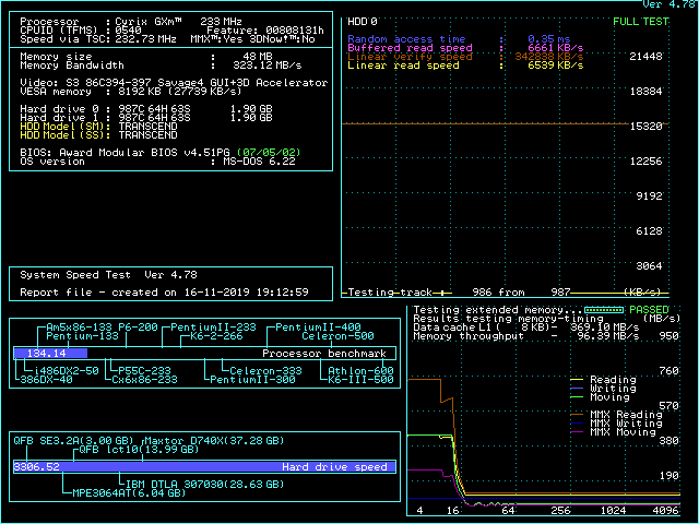

Well, I am now using a Cyrix MediaGX1-300 in this system. I found that by reducing the RAM quantity to just 64 MB, I can still run the memory on its fastest settings and maintain a stable system. Not all GX1-300 chips would run reliably at 300 MHz on this system.
So our systems are growing further apart. I'm using a Voodoo Banshee still. I just ran DOOM and I get 780 realtics, so 95.8 fps (no sound). Using Quake shareware version 1.06, I get 40.2 fps (no sound). I am not using Phil's benchmark pack. Your scores will be a little higher if you use DOOM and QUAKE shareware versions. In DOOM, be sure to first enter the game and hit the + key (the one next to the backspace, not the keybad '+') to reduce the green frame around the screen. Then you can exit and run DOOM from the DOS menu. Just run setup first to ensure sounds are off.
I also re-ran Speedsys (enclosed).

Feipoa, thanks for your detailed response. I have the same experience with RAM as you; 48 MB runs at the fastest settings without issues. 144 MB (16 MB on-board) was unstable with the fastest settings and I tried various sticks of RAM that worked in different systems and were 133 Mhz/CL2. For my DOS setup 48 MB is perfect I think.
Your system with the GX1-300 is clocked 28% faster than mine and this is reflected in the increase in memory speed, memory throughput and the Quake framerate (all +/- 28% faster).
I expected the VESA memory speed to be roughly the same though, but the increase in clock does seem to have effects on the PCI bus... or that Banshee is in an entirely different performance league. Both my Savage4 and G200 max. out around 27000-ish but I've seen Speedsys benchmarks with G200's reaching around 44000, so it's probably the CPU/PCI bus.

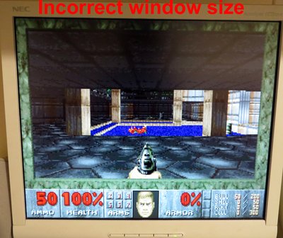

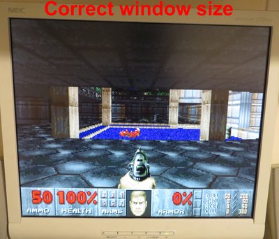

I'm going to re-test Doom when I have time. What version of Doom did you use? You run it with screen-size on maximum with Doomguy's face still visible?

The Doom Demo version. Is there more than one version? I thought there was just one. I think its v1.9. As for the window sizes, see these images I took.
I'm not sure how much you can trust the VESA speed info from Speedsys. Best to run game benchmarks.

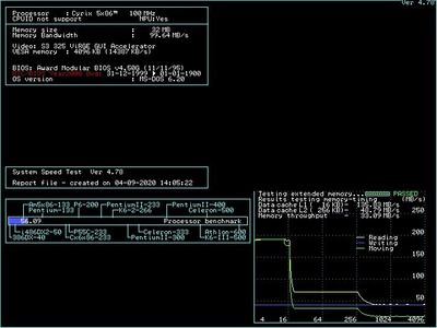

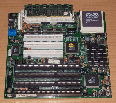

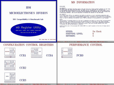

I finally managed to lay my hands on a Cyrix 5x86 derivative or so i suppose. The chip in question is an ST5x86-100. First of all would you please confirm that it really is a Cyrix 5x86 from a different supplier (SGS-Thomson)? The other problem is with the motherboard it came in. It is currently configured to run the CPU fine (at factory settings) but I would like to make some adjustments. However I cannot find a manual or even jumper settings for it. I have leafed through the TULARC database visually checking the couple of hundred listed boards but none of them is identical with mine. Neither did my search with the the BIOS ID string (11/11/95-ALI-1487/89-ALI5119-00) yield any results. If you could recognize or identify this board and direct me to some jumper settings (CPU voltages, cache options, multiplier would be the most important) I would greately appreciate.
508.96 KiB
1499 views

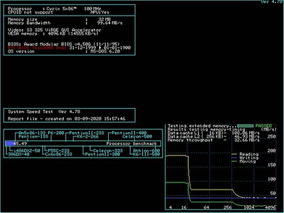

Also since the setup is working as-is I tried some tests but their results were less than expected.
48.37 KiB
1499 views
I cannot seam to be able to set CPU registers. The IBM M9 program has the relevant settings (BTB, LSSER, FP FAST) x-ed out. If I set them either to 0 or 1 and push F3 to write to reg they just drop back to those x-es.
202.84 KiB
1499 views
I would appreciate any tips regarding this situation too.

OK I solved one problem. It seems the CMOS battery acted up in some way because removing it solved my RTC issue. Now I have a loosing CMOS settings when turned off issue though. 😀 Whatever. The more important part is a working timer because Speedsys always hung at the Year2000 bug test while the timer was off.
Now to be on topic here is a screenshot with the best performance settings I could find for the 100Mhz ST chip. The BIOS memory timings were: DRAM speed=Fastest, SRAM speed=2-1-1-1, SRAM waitstate=0, and the 5x86 enhancements were: BTB_EN=on, LSSER=off, LINBRST=on, MEM_BYP=on, FP_FAST=on.
51.53 KiB
1451 views
I have to research a bit but it seems to be quite decent for a 100Mhz chip? The next step would be overclocking it to either 120Mhz (or possibly 150Mhz, but I doubt it could take that much OC) with a 3X multiplier or finding the appropriate settings on the motherboard for 2X50 or 2X66Mhz. So now I'm back to looking for jumper settings for the illusive motherboard.
