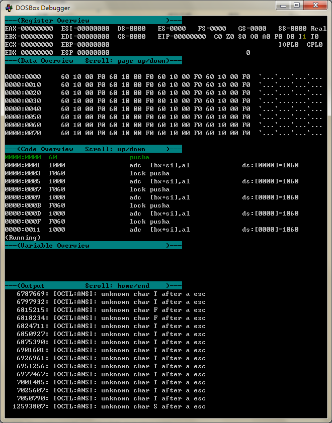

Would there be any chances for a chinese system that doesn't intercept escape sequences properly from dosbox?
I have a chinese demo program here which runs under eten.
When I generate graphics characters from the command prompt on the fly, it works as expected. But when I put this code stream into a C program, the graphics characters just did not come out.
I find out that the program works when it is booted from the dos image.
So i doubt it wasn't the emulated Hardware's fault. But rather something dos implementation is missing. I checked stdout but it was too difficult for me to decipher the code. Here is the code snippet I am using
printf ("%cSC0,SD0;",27);
looking forward to hearing your advice.

Do I add branches to the switch case in order to support my demo?
    73.42 KiB
    2793 views

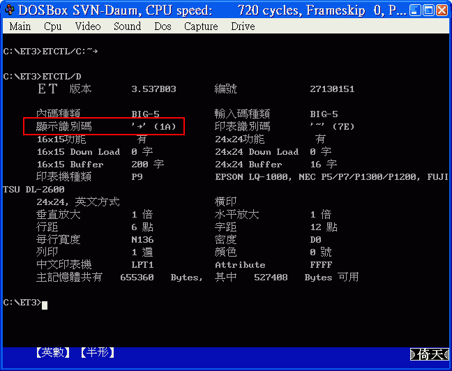

Reply 13 of 17, by coolhaken
You can change the control character of ETEN from ASCII "27" to ASCII "26" using ETCTL command.
Like this:
ETCTL/C:~(Press Alt and numpad "026")
    7.18 KiB
    2120 views
    Change ETEN's control character
