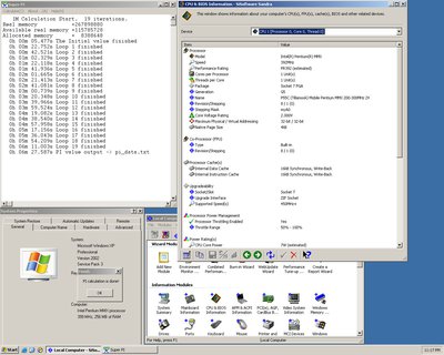

Still the same platform:
CPU: K6-3+450 ACZ
Mobo: P5A-B
RAM: 256MB PC133 2-2-2
OS: XP SP3
But this time I turned off some services and the fancy interface.
112x5.5:
234.19 KiB
No downloads
124x5, no L3:
236.49 KiB
No downloads
112x5.5, no L3:
238.5 KiB
No downloads
Reply 207 of 328, by Skyscraper
Here is my K6-3+ @ 600. I not sure if I already posted this result in this thread.
The OS is Windows 98 SE, I think I would get a better score in Windows XP.
Reply 208 of 328, by lazibayer
Skyscraper wrote:
Here is my K6-3+ @ 600. I not sure if I already posted this result in this thread. […]
I thought 98SE would occupy less systematic resource than 2000 or XP thus applications may run faster under 98SE.
