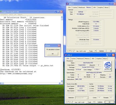

p3 650 @ 866
512MB pc133 (default timings)
asus cubx-e
file.php?mode=view&id=18417&sid=1ab9cff40b5f5b01bbcc9941f622d6d5
stock was a little over 3m, so that's, fine, the board is very easy to play with, well, apart from the ide controllers (specially the promise 100 corrupting my windows all the time);
    300.13 KiB
    1914 views

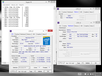

Reply 245 of 328, by underjack
Just for some spice, here's my Dell Venue 11 Pro Tablet, with a Bay Trail Atom Z3770 and 2GB DDR3. I'd say 37 seconds is not bad for 4 watts.
506.4 KiB
1889 views

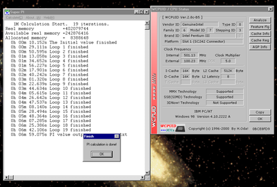

My Retro machine is a Slot 1 PIII 500 on a 440BX running Windows 98SE. I don't have a mouse for it, so it ran the test with my main machine connected to it over VNC.
82.19 KiB
1883 views

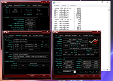

I also tested my Phenom II X6 1090T on a ASUS ROG Crosshair 2 with 4 MB DDR2 and Windows 10 Preview. Result was 20.063 secs. One of the faster times for a 1090T that I've seen.
149.45 KiB
1886 views

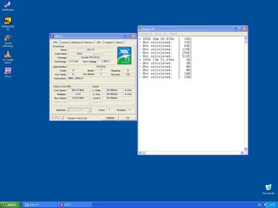

My socket 370 system, specs as my signature but with a VIA C3 866mhz EZRA CPU, 133mhz x 6.5. It's staggeringly slow!!! 13 m 51.696s, think the BIOS may have an issue with it mind you, as it is reported as a Pentium II 866mhz. Saying that, VIA CPU's are dreadful at superpi!! My C7 cpu was terrible at it as well!!
Reply 247 of 328, by SPBHM
🤣 this brings me back some memories, I remember when my father bought a cheap laptop from PC CHIPS called "desknote" with external battery back in 2002 or so, it had a VIA C3 Samuel (I think) 733MHz, super pi took 17 min 🤣
so I think yours is performing perfectly!

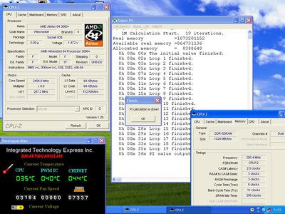

I enjoy seeing some vastly different hardware performing the same, and I also happen to find one of my Winchester OC tests back in 2005,
166.83 KiB
1817 views
Reply 252 of 328, by underjack
Hey, I've got a Socket 754 3000+ of some variety in my closet. That was, oh, three CPU's ago.
Reply 253 of 328, by SPBHM
I've sold this one in 2005 🤣
this one was the first 90nm revision Winchester and I wanted the Venice model (SSE3 and higher OC...)
I would love to still have that PC, it was running with a rather nice nforce 4 motherboard and 6600GT from EVGA... but at the time I always used for a while and sold most of my hardware.... only a few screenshots left...

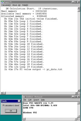

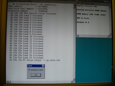

My new Digital Venturis 466 Socket 3 system with a Pentium Overdrive 83 MHz.
The POD is very fast compared to 486 CPUs when it comes to SuperPi eventhough this system lacks L2 cache.
POD 83 @83MHz, SIS 471 no L2 cache, 68MB (4+32+32) memory with unknown timings: 55m 13s
4.19 MiB
1503 views
For comparison my Intel DX4@120 MHz with 256KB cache and tight timings running on a Asus PVI-486SP3: 1h 41m 27s
142.73 KiB
1502 views
Reply 258 of 328, by havli
Both of these scores looks kinda slow. My best superPI 1M on 486-class HW is 37 min, 47s. AMD 5x86-P75 @ 160 MHz + Abit AB-PB4 + 64MB EDO, win NT 4.0.
http://hwbot.org/submission/2341999_havli_sup … min_47sec_761ms
Maybe there is some kind of a bottleneck in your system?
Reply 259 of 328, by Skyscraper
When it comes to the POD the main reason is of course the lack of L2 cache and (probably) slow timings but also the OS.
When it comes to the DX4 I think the OS is the main reason. Windows NT4 is much faster when it comes to SuperPi. The AMD 5x86 CPUs 33% extra clockspeed should explain most of the rest of the difference.
There is also the possibility that the VIA chipset with its better EDO support is faster than the SiS ones in SuperPi but anyhow the Asus board had all timings maxed out except for some memory refresh setting which I later found improved the performance ~1%.
