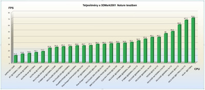

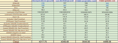

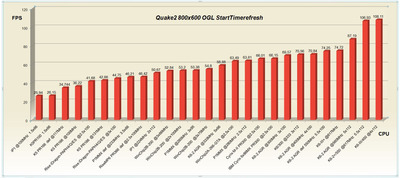

You need a good setup and you're near Intel or better ...
