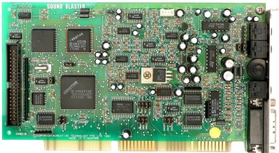

ISA pinout for reference: http://ferretronix.com/ixr/octagon/ISA_Bus_pins.png
The left side of the CT1600 is fed from the +5V B29 pin of the ISA port, that includes the Bus Interface (CT1336A), DSP (CT1341) and all CD-ROM IDE chips, and the YMF262.
But most analog components responsible for amplification are fed from the 78L05/79L05 TO92 regulators which is fed from the +12V/-12V rails , that includes the Mixer chip (CT1345), all the 3403 op-amps, and YAC512.
The big AN7809 regulator in the middle feeds 9V to the TEA2025B Power Amplifier chip and nothing more.
So the YMF262 and YAC512 are fed from different 5V sources.
All analog components regulated on board using a 78L05, but all digital components are fed straight from the 5V rail on the motherboard/ISA.
I cannot assume that the noise comes from the analog part of the board (+/- 5V from the regulators from the 12V rail) because the PCM audio and power amplifier are very quiet, that includes the YAC512 DAC.
It may very well be that the high frequency oscillation from the motherboard somehow affect the digital signal of the YMF262 chip before the YAC512.....?

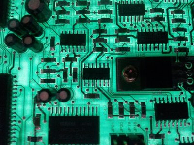

I traced the the rout of YMF262 -> YAC512 -> 3403 -> Mixer.
YAC512
3403
879.44 KiB
420 views
If you look in the datasheet of the YAC512 the configuration on the SBPro2 is EXACTLY as per the datasheet.
All four op-amps of the 3403 outlined in red are used for the YAC512, from there CH1 and CH2 go through electrolytic coupling caps directly into the mixer.
The most noise sensitive part of this configuration is the AOUT and CTB of the YAC512 right on the 3403 pin, if I touch them with my finger I can pick radio stations waving my other hand as antenna... 😁

Anyway, yes schematics-wise it may look perfect, but if you look at how the thing is wired on PCB, then you'll start to see things.
http://www.yjfy.com/images/oldhard/sound/ct1600_1991_1.jpg
As it is a cheap consumer product, I have to assume is made with only two layer PCB, so there are no ground layers between top and bottom layers. Can you verify this (my card is somewhere I can't reach it now)?
And every loop of wiring is a coil that picks up magnetically coupled noise, coming maybe from other loops (coils) on motherboard. Also look at the grounding if it is made in star configuration or just random, because if there are digital return currents on analog return path then the analog ground is noisy, so in this case it does not matter if the 5V is coming from a squeaky clean audiophile regulator (which of course the 78xx and 79xx aren't, but they should be good enough for analog audio...)
The thinking noise can be greatly affected by moving the sound card to different slot and moving other cards away from it (when possible).

Yep, only two layers front and back.
The digital and analog grounds are different and go to different pins on the ISA slot, the do not interconnect on the PCB.
There is a ground bus closer to the bottom in the digital part of the card and everything snakes down to it with thicker traces... close enough to star grounding.
The analog part has practically no ground in the signal path as it has +5V and -5V on all op-amps and practically no ground, this makes the card silent in the PCM part of it, most of the analog grounds are for Caps.
I believe the problem is in the YAC512 DAC part of the card because when FM is muted in the mixer the PCM part of it is very quiet as you can hear in the Doom gameplay demonstration I posted in my bump post.
I don't think the interference I hear is RF, I think it comes somewhere along the leads.
But why only on the YAC512 path? Why the PCM part is absolutely silent using the same regulators and grounds ??
661.83 KiB
382 views
It certainty can be regarded as modern art. 😁

There's a lot of induction pathways on that board. Just look at the routing from the bus chip on the back!
