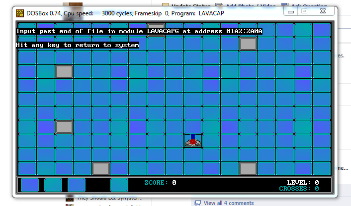

Hey,
I have the 1992 game Lavacap that i have been playing on Windows 98 for forever now, and i want to put it on my good computer. Ive tried a little before, and have never succeeded. Ive always done it with Windows Compatibility Mode for 98. Well, i got smart and now realize what i need to do.
Anyways, i downloaded Dosbox, and ive learned how to use it somewhat(through knowledge of Command Prompt and its built in help) and i cant get this game to run. I attached a file with the error messege. I tried changing the ram from 16 mb to 32 mb and 64 mb. And i messed with the XMS and EMS. Nothing changes.
I just want to play this game that is 4 years older then me! haha
Thanks for any help i can get.[/img]

Loadfix is a dosbox internal program, just run it as lei wrote

Still didnt fix it. Although the code in the errow messege is different, it think.
I dont know if this would help or not, but it gave me that same error when trying to run it directly off of XP or Win7.
Also, i know dos doesnt support usb keyboard and mouse. Do i need to be using PS/2 keyboard and mouse to make this work?

Shareware versions 1.1 and 2.1 are working with no apparent problem in DOSBox 0.74 with default settings. What version do you have? It should say on the title screen.
Do any messages appear in the DOSBox Status Window after running the game?
You said the same kind of error occurs in Windows, so maybe you have a bad file and just need to replace it from a known good source.

Nothing appears in the status windows. Its version 1.1

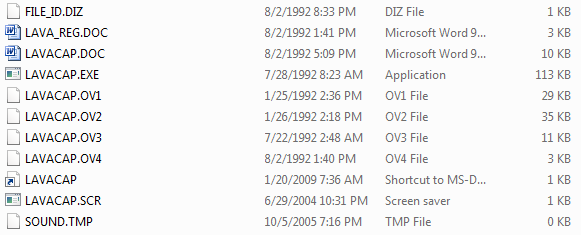

In addition to the executable, there should also be overlay files (.OV1 through .OV4 in the case of shareware v1.1); but I doubt you're missing those because the game would halt at startup and tell you that there are missing files. Most likely you have a corrupt file.

I have all of them. I attached an image of the folder's contents. Anything seem out of the Ordinary? Ill try running dosbox as an admin real quick.
And if that fails, i will go and retry to transfer it from 98.
Where the heck would i download it from? i cant even find anything about lavacap on the internet. I searched this forum for anythingabout Lavacap, and found nothing. I was kinda wondering if it was long and forgotten even by the dos people, but oviously its not.

I reproduced the error with a zero-byte SOUND.TMP file in the game folder, as you have, so delete that. It's not a distributed file, and although the game does try to open it, I've not seen it try to create it.
Reply 13 of 16, by xb2003
Muhaha that worked. It runs. Its wierd to play lavacap with a lazer mouse. Ill get used to it. Anyways, thanks. for helping me get this working.
