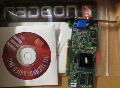

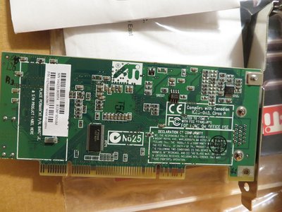

Reply 20 of 32, by feipoa
There was some thread where someone mentioned to me that they have what looked identical to the Mac version of the 128 GL, but worked fine in his PC.
As for the NIB card from that interloper seller, unless you are after a Rage 128 Pro in PRO format, I wouldn't buy it. His listing said it was for 128 GL, I bought it (some time ago), and the card was a 128 PRO. I mentioned this to him, but he didn't respond to me. Here's some photos of the contents.
Notice how the card says 128P? I believe the "P" is for "Pro". When I went to setup the drivers, it said it was Rage 128 Pro.

Reply 21 of 32, by aspiringnobody
feipoa wrote on 2019-07-16, 08:29:
There was some thread where someone mentioned to me that they have what looked identical to the Mac version of the 128 GL, but w […]
If you still have this card, would you be able to dump the bios for it? It might be what I need to get one of those Diablotek Rage 128 Pros booting on my vintage PCs. The bios must have an SSE/SSE2 instruction in it because the card never initializes on retro kit. Works fine in newer computers, although I don't know why you'd want to use it in them.
The PCB layout of this card is identical to the Diablotek "reproduction" except this has a copyright of 2001 and the Diablotek has a copyright of 2003. Maybe this card has an older bios as well?
Thanks!
