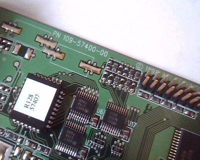

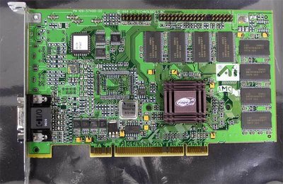

Reply 14 of 20, by chrisNova777
i actually made another post over on msfn.org
https://msfn.org/board/topic/179556-looking-f … comment-1167642
i forgot to put the pic of the card; its very common because all powermac g3 b+W shipped with it as far as i know
attached is the photo
as u can see it is not socketed; and the p/n in the photo says: 109-57400-00
my card has the same p/n but is slightly visually different in placement of the p/n number and the actual chip doesnt have a heatsink like the one pictured;
the chip itself says "logo:(graphics by Rage 128 ATI), Rage 128 GL; 215R4GASA22; PD26133; 9906AA; TAIWAN"
there are many other threads on the net about people trying to "crack this nut" to achieve the same result; (ie: make it work in a pc)
ive seen noone reporting any "SUCCESS!" posts tho;
i dont know what other flasher programs i can try that will "see" the card; probably because its a mac card;
maybe i have to try to flash it on a mac with the pc rom/bios

Reply 15 of 20, by Warlord
I honestly don't think it is possible. While there may exist PC compatible Rage 128 PCI cards, they had differn't board layouts, memory ram chips than the Apple ones thus those BIOS will not work.
If you really want a Rage 128 PCI look for Diablotek VAR128P-32P

Reply 17 of 20, by Warlord
As an example this card here, I cannot read the bios but this maybe a PC version of that card but it is very different. As you can see The AMC connector is stripped down. It doesn't look like a full AMC connector. Traditionally the AMC connectors were the same number of pins as a IDE. 2nd thing you notice is it has the rage Theater chip for DVD decode and capture on the PCB, where as the MAC cards you needed a daughter board that had the theater chip on it. so if you flashed your mac card with this BIOS that would probably brick your card.
