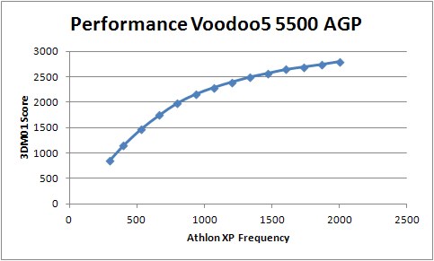

Edit: I just ran a few benchies, here is the result:
    26.66 KiB
    1111 views
    benchmark graph

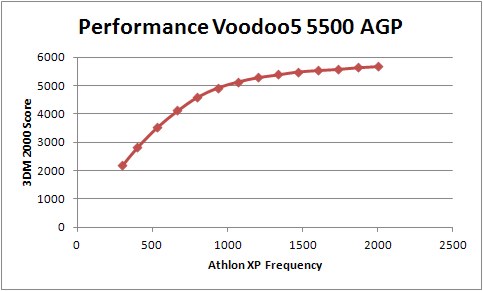

Reply 83 of 119, by ux-3
NitroX infinity wrote:
Hmm, I'd love to see a graph like that for 3DMark 2001se build 330.
Here you go...
    26.29 KiB
    1091 views
Retro PC warning: The things you own end up owning you.
Reply 86 of 119, by NitroX infinity
Correct. I've run 3DMark2001se many times with my Voodoo5.
Reference point; I got about 2550 points with my P4 2,26GHz, about the same as with an Athlon XP 2000+.
NitroX infinity's 3D Accelerators Arena | Yamaha RPA YGV611 & RPA2 YGV612 Info
