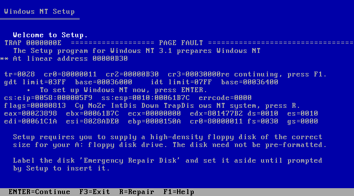

SA1988 wrote:
found out the issue why the NT 3.1 installer and itself (the whole OS) goes on nuts when I click anything in DOSBox-x menu or in the window (not in the guest)?
It sounds like you're running a version of DOSBox-X that pre-dates the mouse INT33h emulation fix I described several post up. Latest versions of DOSBox-X do not have that issue.

SA1988 wrote:
actually, I compiled your latest source from last April 17th and it still happens
Really? Could you provide your dosbox.conf?

Reply 374 of 2397, by SA1988
okay, here it is + screenshot

    this happens whenever I click "Drive" in the dosbox menu.

Reply 376 of 2397, by TheGreatCodeholio
I see the problem:
core=normal
Change it to:
core=dynamic
I wish I had the time to look deeper into it but the normal, full, and simple cores can't run Windows 9x/ME/NT properly without crashing.
also, I never considered yet running NT with cycles=max before, thanks for showing me that works 😀
DOSBox-X project: more emulation better accuracy.
DOSLIB and DOSLIB2: Learn how to tinker and hack hardware and software from DOS.
Reply 378 of 2397, by TheGreatCodeholio
SA1988 wrote:
still happens 😒
Did you compile it 32-bit or 64-bit?
A 64-bit build as far as I know does not provide a dynamic core. The dynamic core is x86-32 only.
Reply 379 of 2397, by SA1988
TheGreatCodeholio wrote:
SA1988 wrote:
still happens 😒
compiled with MinGW-builds and to be 32-bit.
Edit: I compiled it with --enable-core-inline in my MinGW environment and my host is Win7 64-bit SP1 Ultimate. Now re-compiling it without enable-core-inline.
