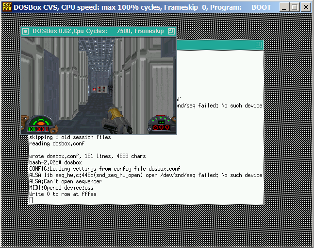

I now have a custom image of linux using UMSDOS and it resides entirely on a fat16 disk image. It boots into the command line and requires just a couple of commands to start a minimal window manager. I believe it should compress to about 250 megabytes and the license allows for distribution of modified binaries. If others are interested in this disk image and have a site to host the image, please post below.
The image is based on slackware 10 and there are many additional packages available, including versions of "wine". I was able to run a past version of dosbox inside this linux guest. Also, the linux installation is further customizable since the user can write to all files. I customized many parts of the OS, including the bulk of the startup scripts (rc.d), msdos.sys, the kernel boot parameters, and the startx, xinit, and xorg.conf configuration files.
Attached is an image of Dark Forces running in dosbox 0.62 inside linux inside dosbox(-x). As expected, the frame rate was low. As an alternative to using X11, the console mode seems very responsive; given svgalib is supported in the above configuration, then SVGALib games could be tested. I believe that SDL has a svgalib driver.

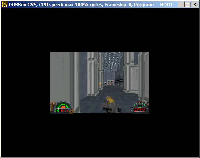

The framebuffer console is an alternative to X11, at least for running dosbox within dosbox/linux. It seems more responsive to input at a better frame rate. To use this device via the bash shell: export SDL_VIDEODRIVER=fbcon. Music, sound, keyboard, and mouse are working. This may work for some SDL applications/games; attached is an image of dark forces running by this method.
I recall that an early wine version accessed the fbcon device, but I haven't confirmed this. I wonder if this would be an easier path than porting wine directly to SDL.

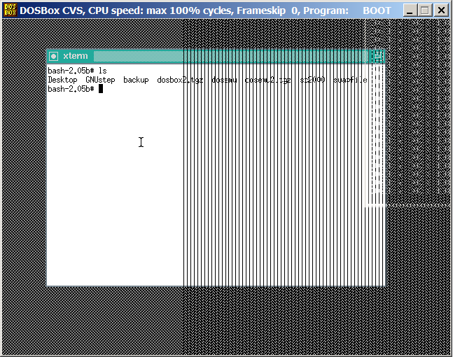

The 3dfx framebuffer device (3dfx-fb) is working in the Linux guest! This device replaces the vesa framebuffer, so that the X windowing system uses the Voodoo emulation instead of the S3 emulation to display to monitor.
To do this, first one finds the PCI slot of the Voodoo emulated card by running the command: lspci. In my case, output showed PCI:0:1:0. This is entered into the relevant line of xorg.conf. Also, the X device driver is changed from "vesa" (the S3 device) to "fbdev". I also set the resolution and bpp to 640x480 at 16bpp. The last setting is in the bash shell: export FRAMEBUFFER=/dev/fb1.
Next, I typed: insmod sstfb. The screen goes blank, but the keyboard is sending commands to the OS. So, I next typed: startx. This will start the X windowing system (and twm window manager as previously configured) which will then utilize the Voodoo as a framebuffer device. Attached is an image of this, including the same graphical anomaly seen in dosbox where running d3d games in the 9x guest (possibly a result of the host OS video driver and an incomplete opengl capability).
Edit: The Voodoo framebuffer in software mode is not showing any graphical artifacts. It also seems to run better and faster than the S3 device, at least as configured.

Cool. 😀
