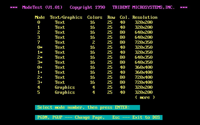

TheGreatCodeholio wrote:
I saw your original comment about the TVGA8900 and Windows 2.x. I have no problem with implementing that graphics card down the line. If I or anyone else here chooses to do it, all you need is the driver and Windows 2.x and time to write another SVGA emulation, bonus if you have an actual TVGA8900 card you can plug into a PC and play with the registers.
I have ModeTest v1.01 for the TVGA8900. Just uploaded it yesterday for DOSGuy in the IRC channel. In case someone need it to write the SVGA emulation then here it is. Haven't been able to find this online, and it came from my old backups.
Awesome. Do you have that specific card's datasheet anywhere? Both the driver and datasheet would help in implementing emulation.
Edit: Sweeeet I even found a TVGA8900 on Ebay
MODESET.EXE came from TVGA8900C Utility Disk and I was able to dig up the drivers as well. As for the datasheet for this specific card I can't really find it. However I see you have some datasheets for TVGA8900D on your server. Not sure if that's the full one, I see scanned photocopied pages.
Link: http://hackipedia.org/Platform/x86/VGA/Triden … 0Controller.pdf
