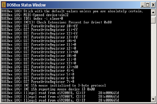

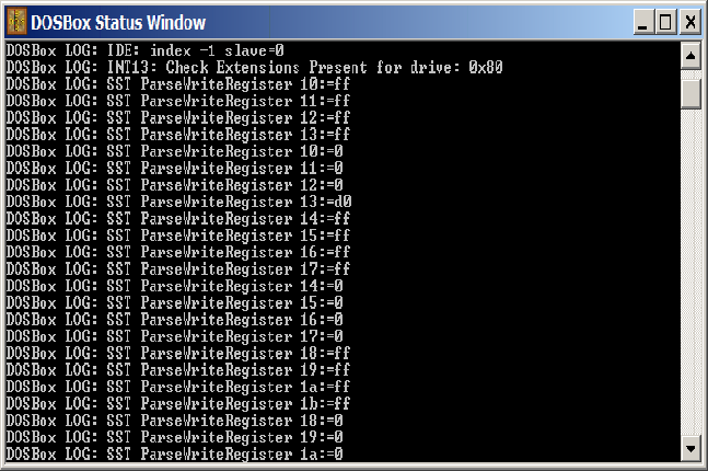

Continued looking at the pci emulation question. Attached are two images, one from the original and the other from the new pci emulation. There are differences in the values that are written to the registers which shows that the V1 emulation is not sending the (presumably) expected series of bytes with the new pci emulation (at least in my case).
    30.77 KiB
    1083 views
    new pci emulation
    29.37 KiB
    1083 views
    original pci emulation

Reply 594 of 2397, by truth_deleted
The above workaround is not necessary, this attached patch fixes the issue between the V1 and the new PCI emulation. The patch corrects a typo error, otherwise all of Codeholio's code is perfect. This probably resulted from the lack of having a simple test of the V1 emulation. 😀
Thanks Codeholio!!
