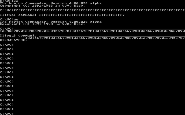

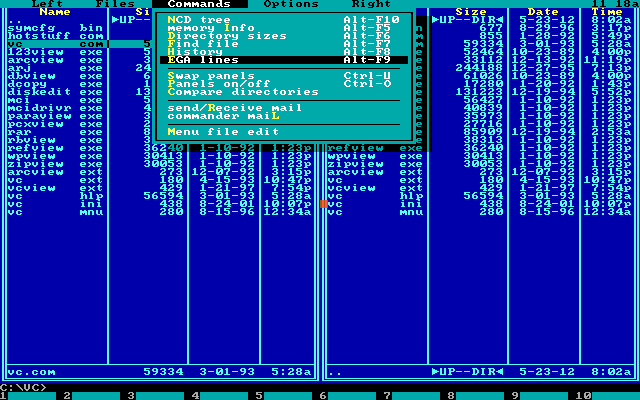

Reply 4 of 18, by robertmo
you mean this?
i just start vc.com alt+F9 to switch to that font (it is called "EGA lines")and quit vc. and it still works.
    9.49 KiB
    2670 views
    3.58 KiB
    2674 views

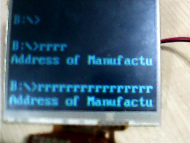

Reply 11 of 18, by chinna
Dear ripsaw8080,
For the first time i am able to change the font size of my application. After running your TSR program from conf file font size increased. and two of my applications are not opening at all.
I asked for reduction in font size but it increased drastically. I want to fit 16 lines of text in 320X240 Display. i am attaching the Display with font after executing 40X16.COM
You have given 40X16.ASM how can i modify & create font sizes so as to fit 16 lines in my display. Yes as you said i want to run purpose built programs.

Reply 12 of 18, by ripsaw8080
Rank DOSBox Author
DOSBox Author
What kind of system is this? DOSBox for phones and the like should use the native 320x240 resolution of the display, but with whatever you're using it's showing the scaler pixel doubling. Double-height and double-width create a normal VGA refresh rate for a 320x240 resolution. You could change the display to normal height and normal width, but the refresh rate would be quadrupled or so, which is not good.
It seems like what you're doing is just showing the upper left corner of the full DOSBox display, which is just a clipped portion, and actual dimensions of the display are past the edges of the visible area.

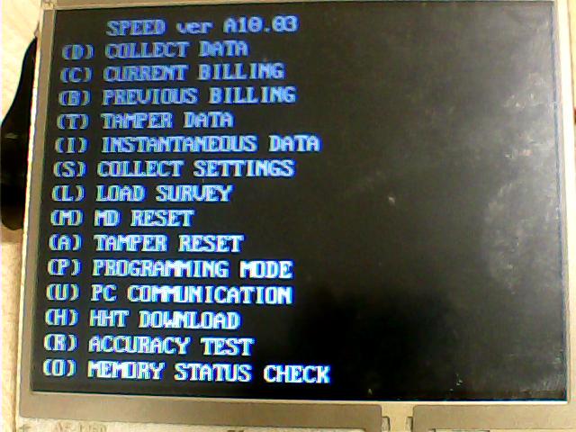

Reply 13 of 18, by chinna
Yes i as you said it is left top of dosbox. folowing is the default display. In which 15 rows are displayed i need to display an extra line. Its is a embedded machine with 320X240 display screen

Reply 14 of 18, by ripsaw8080
Rank DOSBox Author
DOSBox Author
Maybe all you want to do is load a 15-line font, but that doesn't change the emulated display dimensions to 320x240; there will still be active screen area beyond the right and bottom edges of your 320x240 viewport.
If you just want the font, get the PC Mag FONTEDIT program available here:
ftp://ftp.pcmag.com/archives/volfiles/VOL7N15.ZIP
Run the font editor, move the cursor to the last row and press F1 to delete the row. Then you can save the 15-line font and reload it subsequently.
You can, of course, use any other font editor program you prefer.
Reply 15 of 18, by chinna
I will try what you suggested.
There will be active display area beyond the boundaries. I dont worry about that bcos i adjusted the cursor to be at the bottom of my display active area, when i exit the application. my only problem is to to get displayed the extra line which is going below the active area wich is below the option (O) MEMORY STATUS CHECK as displayed in the figure shown in last post
Thanks for your support and time..
