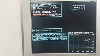

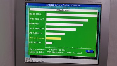

Motherboard is Aquaris MB-4D33/50 OPTi 495SX Motherboard.
My Dataexpert OPTI 495SLC motherboard is broken because Hardcore testing.
Not use any software/drivers. (such as 486drx utility)
    1.5 MiB
    2194 views
    Speedsys Overall - Cyrix 486DRx2 66MHz + IIT 4C87DLC 33MHz
    1.36 MiB
    2194 views
    Speedsys Memory - Cyrix 486DRx2 66MHz + IIT 4C87DLC 33MHz
    1.82 MiB
    2194 views
    NSSI CPU - Cyrix 486DRx2 66MHz + IIT 4C87DLC 33MHz
    1.83 MiB
    2194 views
    NSSI FPU - Cyrix 486DRx2 66MHz + IIT 4C87DLC 33MHz

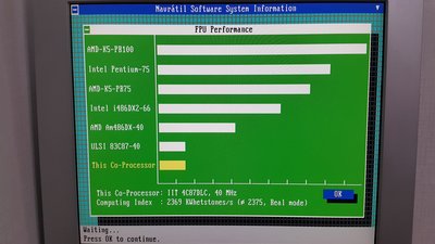

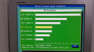

Reply 167 of 325, by skv400
Motherboard is Aquaris MB-4D33/50 OPTI 495SX Motherboard.
same 40MHz, same FPU, but fpu performance reduced 50%.
very interesting result.
    1.56 MiB
    2194 views
    Speedsys Overall - AMD 386DX 40MHz + IIT 4C87DLC 40MHz
    1.34 MiB
    2194 views
    Speedsys Memory - AMD 386DX 40MHz + IIT 4C87DLC 40MHz
    1.8 MiB
    2194 views
    NSSI CPU - AMD 386DX 40MHz + IIT 4C87DLC 40MHz
    2.02 MiB
    2194 views
    NSSI FPU - AMD 386DX 40MHz + IIT 4C87DLC 40MHz
Youtube Channel : https://www.youtube.com/channel/UCeaVPa3VMe9nUGDtFtVzvDQ

Speedsys rating of 9.04 for the DRx2 33/66 vs 8.84 for the DLC-40 is very close (TI486SXL gets 10.13). This is probably the reason why I sold my DRx2 in the first place, the clock doubling seems to offer very little. The DRx2 is so rare and expensive, and the DLC-40 so common and cheap. Unless you are a collector, why bother?
Actually, the DRx2 is supposed to have built in cache coherency which makes it desirable for people who want to upgrade very old 386s.
The increase in FPU performance is interesting. I noticed the jump using Cyrix chips as well. I wonder if it is real, or just a benchmark anomaly.

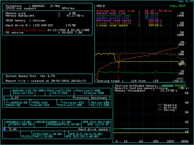

Reply 170 of 325, by GL1zdA
Results from my IBM PS/2 Model 70. This one has the IBMish 20 MHz 386 with no cache (Like this one).
10.41 KiB
2111 views
IBM PS/2 Model 70, 386 20 MHz
Full report (including a report for the 120 MB DBA drive):
System Speed Test Ver 4.78 Report file - created on 20-01-2016 20:56:11
CPU is in V86 mode: No
Processor : 80386DX 21 MHz
CPU speed index : 2.29
Total memory size : 6 MB
Memory Bandwidth : 47.17 MB/s
VESA video memory : Unknown
Hard drive 0 : 115C 64H 32S 115 MB
Tested in FULL mode
Average/Max seek time : 26.38 ms / 40.88 ms
Random seek time : 23.44 ms
Track-to-track seek : 10.15 ms
Random access time : 35.14 ms
Linear verify speed : 552 KB/s
Min/Max verify speed : 281 KB/s / 588 KB/s
Linear read speed : 439 KB/s
Min/Max read speed : 318 KB/s / 579 KB/s
Buffered read speed : 766 KB/s
Hard Drive speed index : 5.44
Year2000 Bug : 31-12-1999 01-01-1900
OS version : MS-DOS 7.00
ATA/ATAPI Device Information
IDE0─┬─Master─<Empty>
└─Slave──<Empty>
IDE1─┬─Master─<Empty>
└─Slave──<Empty>
IDE2─┬─Master─<Empty>
└─Slave──<Empty>
IDE3─┬─Master─<Empty>
└─Slave──<Empty>
Cache/Memory Benchmark
│ Read │ Write │ Move │ Average │
│ Memory │ 10.41 MB/s│ 14.72 MB/s│ 14.45 MB/s│ 13.19 MB/s│
Memory Modules Information
SMBus/i2c Host Controller : Not Present
Show last 4 lines
End of report.

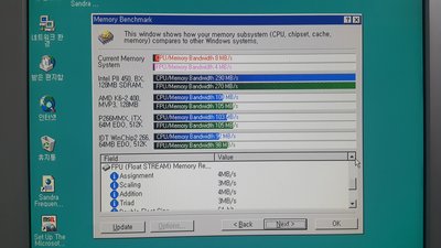

Reply 172 of 325, by skv400

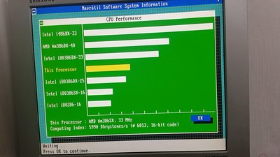

CPU : AMD 386SX 33MHz
FPU : Cyrix FasMath CX83S87-33-GP 33MHz
M/B : Seritech ALI1217 386SX Motherboard
RAM : 70ns 16MB (4MB x 4)
VGA : ATI VGA Wonder 1024D ISA
I/O : IWill SIDE ISA+I/O
HDD : IBM 12GB 2.5" IDE
speedsys benchmark is here : https://youtu.be/EpH2NLcifh0
sandra benchmark is here : https://youtu.be/GRIiRui9DIE

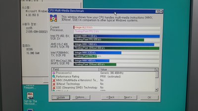

Reply 173 of 325, by skv400
FPU : ULSI SX/SLC US83S87 40@33MHz
speedsys benchmark is here : https://youtu.be/_cj_b6W1UU4
sandra benchmark is here : https://youtu.be/xvDWmiXxYJw

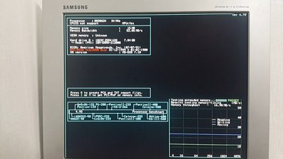

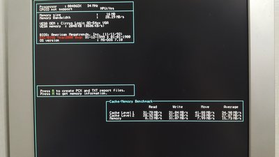

Reply 175 of 325, by konc
You guys are posting pics of really fast 386s. A SX/20 is missing I guess, so here's my Samsung Deskmaster 386SX@20MHz just for reference. No cache.
(Yes, it's an SX wrongly recognized by SpeedSys as DX).
1.28 MiB
2008 views
Reply 176 of 325, by Anonymous Coward
Skv400, I can't speak for the rarity of the ti486sxl, but it is certainly far less expensive than the 486drx2 33/66, which can fetch over 100usd. I have 3 ti486sxl and paid no more than $15.
Konc, are you certain your system has no cache? Your speedsys graph almost looks as if your chipset has 16kb cache.

Reply 179 of 325, by konc
Positive, I was referring to L2 cache on the m/b. 16KBs of on-chip L1 are obviously there and correctly detected.
In fact I was puzzled by SpeedSys's incorrect detection of this SX. I did open the case and visually confirmed it's an SX@20MHz and, just to be 100% sure, also ran a couple of other "system information" utilities that did identify it as such.
