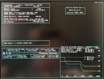

I'm late to the party, but here's my 386SX25 with VLSI SCAMPSX chipset (from this motherboard 80386 BIOS image collection)
This one actually has a really cool bios that lets you tweak settings like RAM waitstates, by how much you want to divide the CPU speed when turbo is enabled (1,2,3 or 4), and other things.
With the most optimized settings, here's the score I get :
14.97 KiB
1965 views
It scores at 55 in topbench.

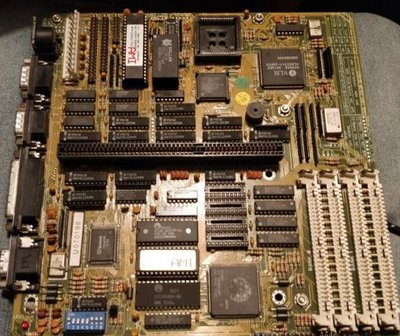

I also fixed this motherboard recently which actually uses the exact same chipset, but comes with a SX33 😁

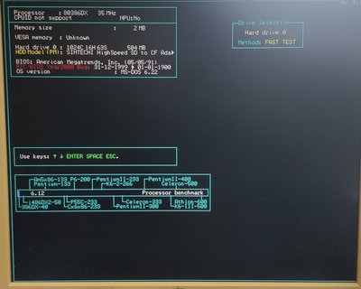

The BIOS is way less permissive ... But wait a minute, what if I just put the bios from the other motherboard in this one instead ?
You guessed it, it worked flawlessly 😁 (sorry, no clean screenshot this time, it was just a quick test)
460.51 KiB
1965 views
It scores at 60 in topbench. The smaller gap in topbench is explained by the integrated OAK video card which kinda sucks.
Also, it scores almost equally to my 386DX 40 🤣 (though probably the FPU is making the score of the DX40 way lower than it should)

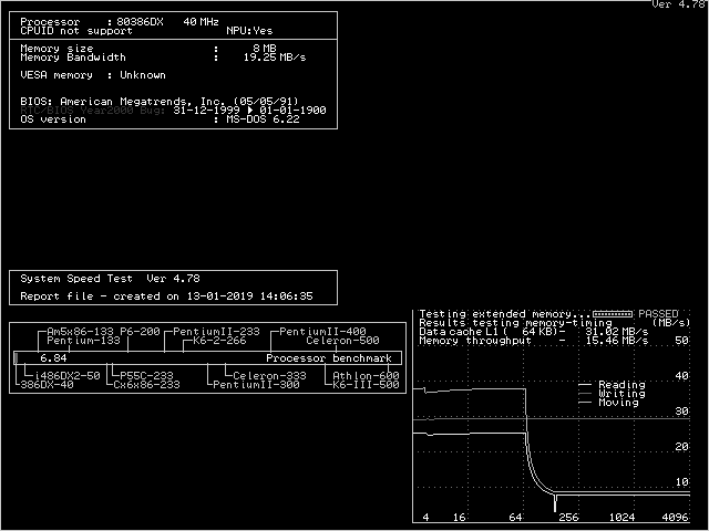

Here's my Am386DX-40 on a Seritech SER-386ADIII with 8mb of 70ns ram and a Genoa 7900 (ET4000AX).

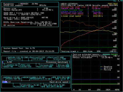

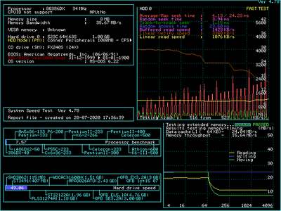

So I just decided to run speedsys on my newly built 386
Ive read that the numeric processor gives you much lower results at around half of what it should be, and even disabling it in the BIOS doesnt seem to fool speedsys into not detecting the NPU.
I guess these results are fairly typical, but my main concern was the linear read speed that seems rather low compared to what others are getting.
It told me I had to disable smartdrive and 386 memory management which I did, my first test with smartdrive enabled did give be a slightly higher linear read speed from the HDD, but nothing to speak of.
Specs:
AMD 386 DX40
ASUS ISA-386U3
Seagate Medallist 520MB HDD
Cheap trident card while testing
16MB 70ns RAM
64KB of cache (soon to upgrade to 256KB)
IIT 3C87-40 NPU
