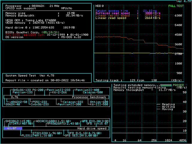

Reply 304 of 325, by Disruptor
CPU Intel 80386 SX 20 MHz
BOARD Topcat Chipset
BIOS QuadTel
RAM 20 MB RAM (16 MB + 4 MB EMS)
SCSI Adaptec 1542B
HDD IBM DPES-31080
NET Intel EtherExpress PRO/10
SOUND SB16 CSP
VGA TSENG ET4000 W32 ISA
I'm sorry, I could not find a working VESA driver but tlivesa.com for vanilla ET4000 with VESA 1.2 support.
Windows 95 is running quite smooth for a slow clocked 386SX. .WAV system sounds are converted from 8-bit PCM via 16-bit PCM to 4-bit CT-ADPCM and decoded by CSP chip. GUI acceleration is done by Tseng ET 4000 W32. HDD access is done by busmaster Adaptec 1542B.

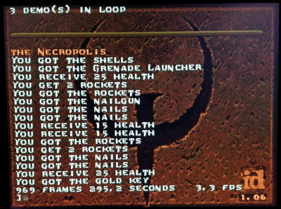

Wanted to share some notes about SXL2 CPUs based on past findings.
SXL2-50 has very high chance of running at 60-66 MHz but only on relatively slow motherboards.
For example this one - native 60MHz (no clock doubling), yet performance is lacking.
On fast clock-to-clock motherboards SXL2-50 does not climb much higher than its specification - tends to max-out at around 55MHz and even that is not very stable.
Below is a Quake 1 score from such system running at 50MHz natively (no clock doubling). Completely stable.
Number can be 3.6 fps if push things to 55MHz at compromised stability - mostly attributed to FPUs getting flaky in the context of Quake 1 and other apps demanding co-procs. So far haven't seen 40MHz rated FPU handling well 55MHz natively on fast board.

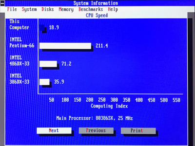

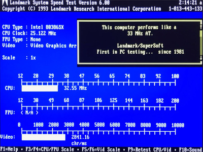

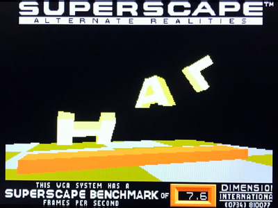

Wow, it looks like I did pretty much every single benchmark I know of except Speedsys on my 386SX-25 🤣
System Specs:
AT Mid Tower (No-Name)
TASK 230W AT
Scamp 386SX
AMD Am386SX/SXL-25
4MB (4x1MB FPM30)
Mitsumi 3.5" DS-HD
512MB CF/IDE (Internal)
CF/IDE (External)
ASUS 50x CD-ROM IDE
Cirrus Logic CL-GD5402 ISA 512KB
Edison Gold-16 (ES688)
MS-DOS 5.0/Windows 3.0

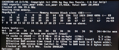

CPU: AM386DX-40
FPU: IIT 3C87-40
Motherboard: FIC 4386-VC-HD
Chipset: VIA VT82C495 (Venus)
Cache: 256KB 20ns with 20ns TAG RAM and 15ns Alter / Dirty TAG RAM for write-back
BIOS: Award 4.20 version 1.15K with "Fast" DRAM Timings and "Turbo" Cache Timings
Memory: 20MB (4x1MB 70ns + 4x4MB 60ns, both Hitachi)
HDD: Maxtor 7540AV 504MB (jumpered for 1024 cyl)
Video: ISA 1024KB Cirrus Logic 5429
no overclocking (ISA / VGA or CPU)
1.08 MiB
1483 views
Even with the "Turbo" setting, cache timings appear to be rather conservative, so I don't believe faster chips would change anything.
910.41 KiB
1483 views
Other Dosbench scores
PC-Player VGA Bench: 4.0
Superscape: 14.7 / 14.5 (slower / faster systems)
Doom slow PCs: 28.34fps (2635 realtics)
Topbench: 79
Chris' Bench score: 13.2
