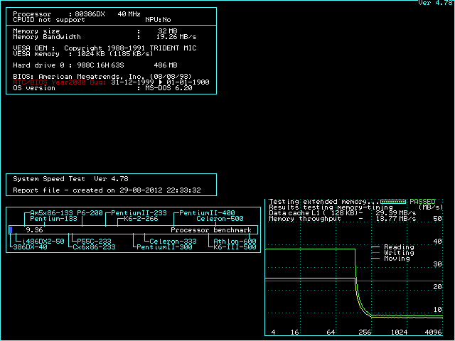

if you get a chance can you test your M326 motherboard with either 8MB or 32MB of RAM. I am curious to know if you board supports page-interleave mode. You need to fill all 8 slots for it to work (if supported)

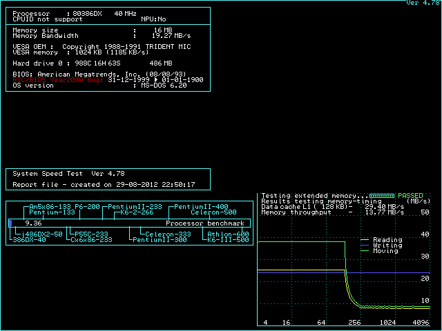

Apologies for being back late.
Here are the results. The first image is the result of using 8 x 4M = 32M 70ns SIMMs, the second image is the result after removing 4 SIMMs (=16M, 70ns). I also tried with another set of 16M 60ns SIMMs, but the result was not changed. It seems that page-interleave is not supported or at least not activated on this mobo.
Strange, I'm not able to achieve the same high score as last time. I only get 9.36 but it was 9.40 last time.

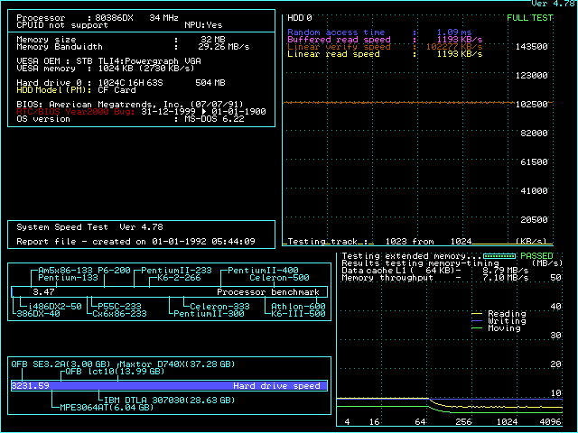

This is a 386 Baby Screamer Series 42 motherboard and 386DX/33. 32 megs of of 70ns 40 meg SIMMs. Its running off a compact flash card, leading to odd hard drive numbers. The memory bandwidth, esp cached, and CPU numbers seem really low, and I'm not sure why. I suspect something isn't running at full speed but can't prove anything.

Reply 42 of 325, by elianda
On first look, I'd say your Turbo is OFF.
Youtube Channel
Reply 43 of 325, by Ailicec
You may be right. The machine starts with the turbo light on, but never boots; after a reset, the light goes off and it boots. Maybe it can't run stably at full speed. However all the CPU speed programs say its running at 33 MHz, so I'm not sure thats it. I may have to get an O-scope one of these days and see if the clock or some other signal is dirty.
Reply 44 of 325, by DonutKing
Also the presence of a maths copro (or NPU as referred to by speedsys) will affect your CPU score. I doubled my 386DX40's CPU score just by removing the 387.
The frequency doesn't have to change necessarily when switching Turbo. There are as well other implementation with waitstates/internal caches a.s.o.

Reply 47 of 325, by Ailicec
The other benchmarks all indicated 33 MHz. The motherboard manual says non-turbo is 8 MHz. The odd turbo light behavior still bugs me, though.
Seems like the cache implementation is crummy or not working right.. it seems to be 33 MHz, but with very little memory bandwidth.
Reply 48 of 325, by Ailicec
For fun, I'm posting this from the 386, painful as it may be. No more luck, I tried different combos of SIMMs and some jumpers, but could only make it slower. Checked the BS16 pin to make sure it was running as 32 bit, and it was.
Reply 49 of 325, by Anonymous Coward
Even without cache, the memory results are complete shite. You have some kind of turbo problem. Did you try to software turbo controls? I think it's CTRL + and CTRL -
Reply 50 of 325, by Ailicec
Yes, I've never got any of the keyboard controls to work. There's supposed to be ones to control turbo, cache, and get in the BIOS, none of them work. Maybe because I had to replace the keyboard BIOS chip? Sad if that killed my performance.. I do have an EEPROM burner, if I ever got the data I could make another one.
Reply 51 of 325, by Anonymous Coward
Do you still have the original chip? It's certainly possible that you did something by swapping it. I think some KB controllers have special programmable ROM.
I seem to recall somebody else on here with an AMI baby screamer reporting that the system would always boot up in slow mode and would have to use the keyboard shortcuts to bring the system to full speed. It wouldn't surprise me if your system had some extra code in the kb controller to add this functionality. Maybe the kb controller you swapped in is missing this extra functionality.
In theory is should be possible to reprogram a keyboard controller. Though it seems some have eeproms and others don't, so you would have to make sure you get the right model. I have a 386SX board made by AMI with the keyboard turbo controls. Unfortunately I'm in another country at the moment and I don't have the tool to read an i8042. I think VOGONS user "feipoa" has the same motherboard as you, and *may* have a tool that can read and reprogram. I think he's a little busy these days though.
