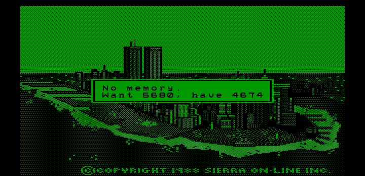

Hi all,
When running this game in hercules mode, there is a problem of "No memory".
This problem doesn't appear when in VGA or CGA .
Please help me. Thanks.

Reply 1 of 9, by nikiniki
I can't read it So I can't pass the copy protection in Hercules mode.

Reply 2 of 9, by ripsaw8080
Rank DOSBox Author
DOSBox Author
I also get the corrupted font with the hercules machine type, but it appears the interpreter version makes a difference. Of course you can cheat and load Magic Key, then run the game with "sierra -c", but you probably already know that. A somewhat involved solution is to use the Gold Rush interpreter (v3.002.149) with a small modification. The hercules support in this later AGIv3 interpreter seems to work correctly. Copy the AGI and *.OVL files from Gold Rush, then search in AGI for the string "IDX", and immediately before that you will find the "GR" bytes that should be changed to "MH" so the interpreter will open the Manhunter data files.

Reply 4 of 9, by collector
Great Hierophant beat me to it, I was thinking that the HGC_FONT might have been missing, but without it, the game will not even start. Using a cracked version would bypass the copy protection, but the font problem, of course, would still persist. I tried the same edit with the AGI from MH2 and it does fix the fonts with Hercules, too. It does not with the AGI from KQ4AGI v2.2, interp. 3.002.086, even though Hercules graphics works in KQ4AGI.

Reply 6 of 9, by coolhaken
I get the corrupted font with the hercules machine type too.
But I copy the file "HGC_FONT" from "Police Quest-In Pursuit of the Death Angel (1987)" to fix that.
I think there maybe some memory access issue when in hercules mode .
Modify "memsize=" in dosbox.conf doesn't help.

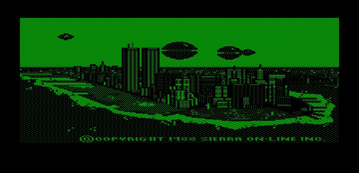

Reply 7 of 9, by coolhaken
Amount of "No Memory" seems effected by cycles of DOSBox.
Is this problem able to be fixed without replace AGI ?
After replace the AGI Interpreter of Gold Rush, Manhunter works in hercules mode.
But the display seems to be "compressed" .
I wonder at how the screenshots of Mobygames generated.

Reply 9 of 9, by coolhaken
I found that the "lack of memory" problem can be skipped before display error message by press <Enter>.
This could also explain why Mobygames have these Hercules screenshots.
And it does not have the screenshot just after error occurs.
