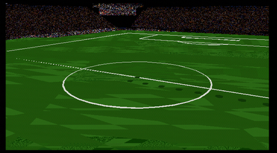

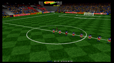

Actua Ice Hockey 2 - maximum resolution is 1024x768 on my PCX1. Framerate is too low though, I would prefer 640x480.
https://vintage3d.org/images/PCX1/ActuaHockey2.png
Wow, looks really good! Unfortunately there is no PCI bus speed that fast enough for the PowerSGL 1024x768...
Some days ago I have retested ATI CIF version of the Actua Soccer: Semi-Finals 3D (IBM bundle) on all of my CIF compatible cards. Above all, although the game has a Win9x installer, the executable itself is a DOS one needs DOS or DOS mode (I have never seen a DOS ATi 3D CIF game or demo before). This game works only on Rage I and II chips ( I; II; II+; IIc). The game can start on 3D Rage PRO and Rage XL, but has serious errors. 3D Rage LT and Rage LT Pro cannot pass the hardware check, the game writes: "No hardware 3D support".
471.81 KiB
2632 views
Actua Soccer: Semi-Finals 3D on Rage IIc
421.11 KiB
2632 views
Actua Soccer: Semi-Finals 3D on Rage Pro

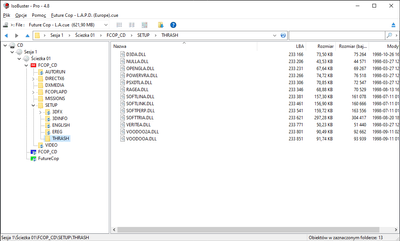

Future Cop: LAPD by EA has PowerVR library in game directory - POWERVRA.DLL
Somebody try ti run this game with that backend?
And.. NFS3 by EA has command line key -powervr or -pcx2. When it run with this key it req'd POWERVRA.DLL

It looks like Future Cop is using the same engine (THRASH) as NFS. So maybe with some hacking it would be possible to run NFS3 on a PowerVR.
Reply 536 of 661, by Babasha
GL1zdA wrote on 2021-12-25, 17:44:
And what about Future Cop? Why it no listed in any list supported/unofficial/debunked?
Reply 537 of 661, by GL1zdA
Babasha wrote on 2021-12-25, 19:32:
I don't know, I won't be able to test it for the next month, but there's a demo of Future Cop and it contains .dlls for many APIs and cards (D3D, OpenGL, PowerVR, Rage, Verite and Voodoo). The same drivers can be found on the full game CD:
    57.98 KiB
    2439 views
    Future Cop THRASH driver folder
Reply 538 of 661, by vetz
It's a previously unknown game, so haven't been checked out. I dont have the availability to check it atm, so if anyone else could confirm on an actual PowerVR card that would be great
Reply 539 of 661, by Babasha
vetz wrote on 2021-12-25, 20:10:
I am already check it in d3d. Next week try to check it on Ati Rage Pro (currently dont have early models like Rage II).
