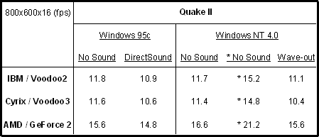

On a different note, I have looking through this thread trying to figure out what I meant by the * No Sound asterisk in the following table. Anyone? How can two "No Sound" benchmarks be so different? I'm sure it will come to me...
