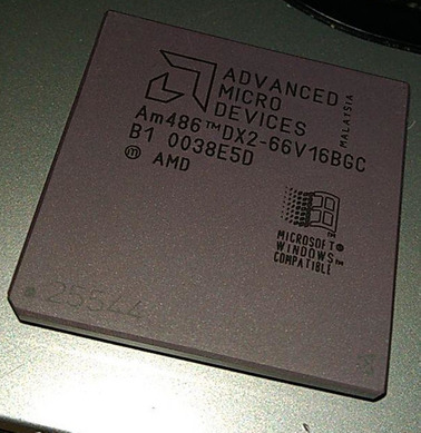

I got a V16BGC DX2 CPU 😀
No need for heatsink, stays cool

Reply 8 of 35, by matze79
Yes, had no time to try it 😀

Reply 9 of 35, by feipoa
It should run at 2x66 or 2x83 MHz if you're into that sort of thing.
