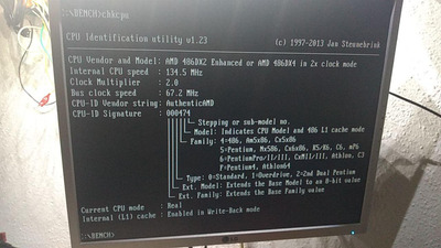

Reply 26 of 35, by Baoran
matze79 wrote on 2020-02-13, 07:59:
I also have a DX2 System who freezes when i press turbo button.. some hardware and drivers simply don`t like the frequency change
I did bit of testing. I changed the cpu type jumpers on my motherboard from amd 5x86-p75 to normal amd dx4. When the jumpers have been set to amd dx4, turbo does absolutely nothing. The cpu is at full speed no matter if turbo is on or off. I also tried the cpu multiplier jumper at both 3x and 4x. No freezes like this but no slow down either so I have no idea what the motherboard is doing. It slowed intel 33Mhz and 66Mhz cpus just fine when I tested the motherboard with those before.
Anyone has any ideas of what is going on?

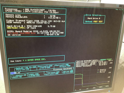

Reply 27 of 35, by matze79
103.76 KiB
191 views
GPL-2.0-or-later
DX2 133Mhz 😀
2x66Mhz
PCI 1: 1/2
But it is not stable, not going to detect harddisk / freeze.
3x50Mhz detects hdd but does not load any data from harddisk
2x50Mhz does boot but has problems reading files correctly
3x40Mhz 120Mhz is stable.

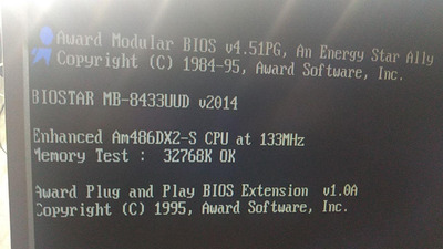

EDIT: Cyrix 5x86 2x50Mhz also not booting, Stuck in BIOS Screen / Detection / Slowed Down Cache not helping
Cyrix 5x86 2x50Mhz - BIOS Auto Setting / Booting - 3WS DRAM.. should find faster RAM iguess.
Video Card is Viper 330. As PCI is running 33/25Mhz Speed it should not be a issue.
The CPU does not even get hot, its just warm!
Did not yet mess around with Settings, this is just quick try.
The System still seems to has other Troubles.,
I inserted 2x 32Mb FPM and it reconizes only 48Mb RAM.
So one Bank is missing, Other RAM same Fun.
I guess this is mechanical Problem i will replace the Banks also..
This Board was heavy abused and i`m glad it works at all.
With 1x 32Mb its stable with normal Settings.

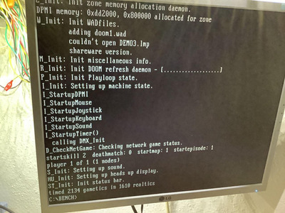

Reply 28 of 35, by matze79
Woho 2x66Mhz booting 486DX2 2x66Mhz without L2 Cache, 3WS RAM
Running DOOM Benchmark!
2134 / 1819 realtics
Some progress, so CPU is stable!

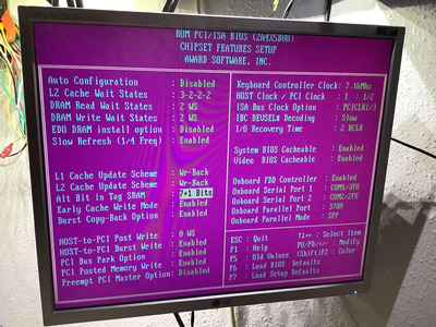

Try to stick with a single stick of 60 ns FPM memory and you might be able to get away with 1 ws of memory read and 0 ws on memory write. 3-2-2-2 for cache is expected. What are you running your IBC DEVSEL at? From memory, I think that is what that BIOS setting is called. For 66 MHz FSBs, it should be on SLOW - not fast, not medium.
Reply 30 of 35, by matze79
Slow, see BIOS Shot on the Image.
I can get it POST with 2x83Mhz but it won`t boot.
3x60Mhz - 180Mhz same, goes until Drive Detection then it woes.
Maybe a slight Voltage increase would get it running at 3x60.
Co2 - for a endless Summer
