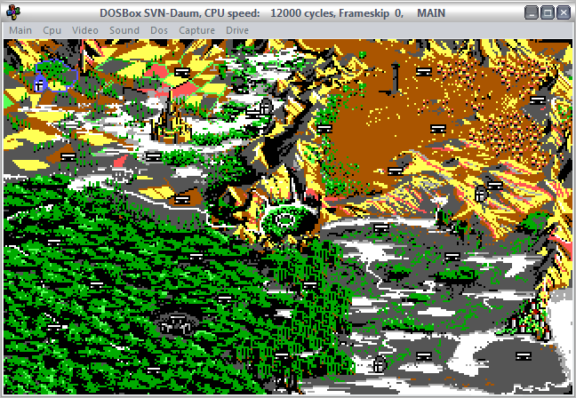

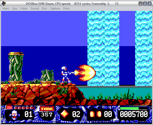

anyway, here's a quick and dirty HLSL port. Needs "shader.code" which is included with ykhwong's distribution anyway.
http://ompldr.org/vZ3ltMg/EGAfilter.fx
I just tinkered with some of the numbers... can't really get it to look "right", and dark gray doesn't show up at all - there's probably a way to fix that, I just didn't try very hard (never touched HLSL before either). Anyone else want to play with this?

Well yeah, it could be done much better. I had a hard time getting even grays. Best to test with an actual EGA game (Commander Keen 4 is a good one for its use of grays)
I think the shader I posted was modified to adjust for OA's overbrights

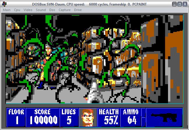

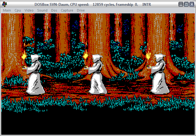

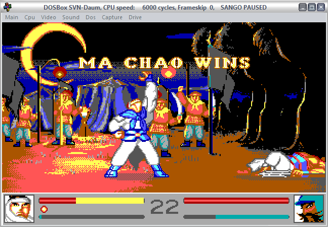

Here's a rewrite... it uses a lookup table for downsampling, so you get dark gray, and actual EGA/tandy games show no changes.
http://ompldr.org/vZ3l4OQ/EGAfilter.fx
Performance is surprisingly semi-OK even on my crap GPU!

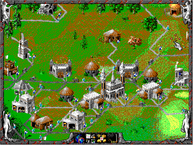

I played Settlers 2 in 16 colours. Not that bad.
    116.62 KiB
    3962 views

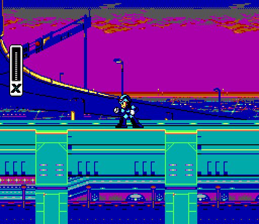

Unfortunately there's bugs with oversaturation like at 4.5, didn't really cap it
Check out the clipping on X's boots
(this is ZSNES in 16-bit color mode)
