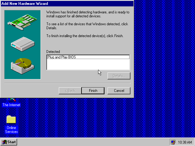

Can someone help me? I activated NE2000 drivers in ykhwong's build and I try to scan my hardware, and I never find it:
(W950109B.ZIP drivers 4 the win!!1!)
As you can see, it never shows up.
Can someone help get my network running with NE2000? I'll accept any help that I get.

You can also try other builds like MB6 for the ne2000 passthrough.
Have you already installed pcap library and configured the ethernet device properly?
http://home.arcor.de/h-a-l-9000/ne2kstuff/db_ne2000.html
DOSBox is intended only for playing DOS games and support for experimental builds is limited.
Reply 5 of 5, by zbyhu
Open DosBox configuration file (dosbox.conf),find [ne2000], and set your network adapter to comunication with dosbox (you should see, adapter list in dosbox status window), e.g. set realnic=1 (1 is a ID of adapter).
