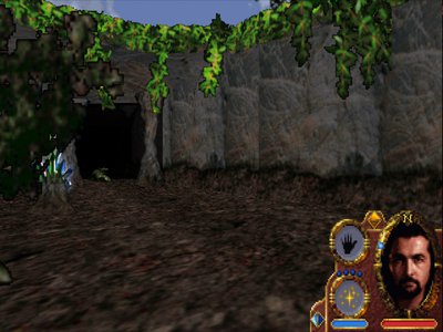

Reply 1082 of 3949, by ZellSF
You can actually use windowed mode to fix Lands of Lore II's AR... Sadly it still has many rendering errors that mar the experience.
See attachment for an example (the seams at the top of the cave below the vegetation, the row of small dots in the ground).
DXGL actually shares the same problem, but it's not as apparent there and occurs in different places.
If you want to look at it Dege, the screenshot is from the start of the game (in D3D mode obviously, software render is perfect).

Reply 1087 of 3949, by Dege
ZellSF wrote:
You can actually use windowed mode to fix Lands of Lore II's AR... Sadly it still has many rendering errors that mar the experie […]
It looks the same with native DX. Or worse, as it has colorkeying problems too.

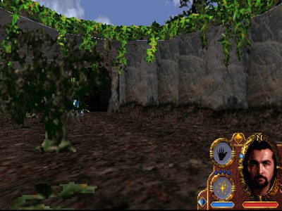

Reply 1088 of 3949, by ZellSF
native DX likely is wrong, it should probably look like the attachment to this post (that's Win95 under DOSBox, running the D3D render).
