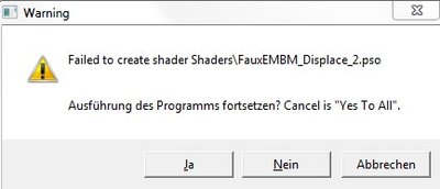

I fullscreen mode Morrowind crashes immediately with Pixel Shading enabled. If you run the game in a window it shows this error message:
16.24 KiB
3074 views
If you close the message the game will continue to run but water will flicker on and off like crazy.
This doesn't happen with Pixel Shading disabled but some effects are missing.
Also there's some z-fighting.
