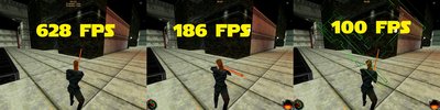

Reply 1605 of 3949, by Trank
So an issue with dgVoodoo in JK/Mots is the hud/map. It seems to really take the FPS off. Though of course this is partly a Jedi Knight issue. But if you dont use dgVoodoo the fps is cut less, and i mean way less.
Didn't checked myself, but I'm aware of that. Unfortunately it's still an issue but I'm planning to improve vidmem access in the future.
