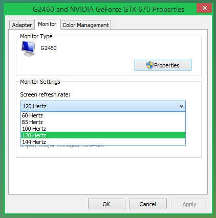

On-topic again: Please say you have any idea about my problem Dege 🙁. My last 60hz monitor is gone soon.

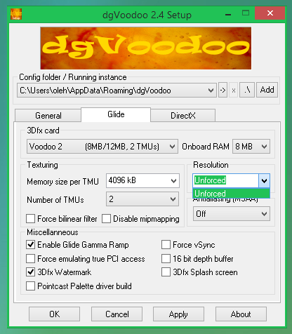

Reply 287 of 3949, by Dege
dgVoodoo's DDraw always reports the refreshrate the desktop runs at, to the applications, so I guess all games should use that because it's common that refresh rate is set to 0 (default) or the one they queried from DDraw.
1. Could you see what refresh rates are supported for your monitor, through dgVoodooSetup?
2. Have you any problems running Glide games (they usually use 60Hz if not overriden in the setup)?
3. What FPS Fraps shows if you runs a DX game with forced vsync?

Reply 294 of 3949, by ZellSF
Dege wrote:
dgVoodoo's DDraw always reports the refreshrate the desktop runs at, to the applications, so I guess all games should use that b […]
1: only place in dgVoodoo setup that shows resolutions and refresh rates is "Resolution" in the "Glide" tab. According to that setting, my 120hz monitor does not support resolutions or refresh rates at all: Unenforced is the only option. Replace 120hz monitor with 60hz monitor and I get lots of options.
2: Outlaws and Undying (Glide renders) work, but they don't really ask dgVoodoo2 for supported resolutions: they have a set list of resolutions to choose from.
3: 120 FPS.

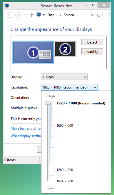

Reply 295 of 3949, by Dege
lowenz wrote:
So that's why I heard complaints from others using Win8. I was made sure that there is no significant difference between Win7 and 8 in the respect of the graphics drivers and architecture but I'm changing my standpoint.
Dege, here's a ddraw generic fix for Windows 8 and Windows 8.1: http://www.blitzbasic.com/Community/post.php? … 77&post=1202630
Can you implement the fix (Windows 8/8.1 only) in future versions of dgVoodoo?
But dgVoodoo does not need those ACT fixes since it uses DX11 not old DX (if I got it right you were after all managed to reach no-vsync in Undying and UT99 so everything is working perfectly 😀 ).
Or, were you meaning including the fixed version of the MS ddraw in the pack?
Hm. It's strange because the enumerated resolutions and refresh rates are queried from the system.
What if you try to set the desktop resolution and refresh freq through the system GUI? You get only 1 (the native) resolution as the only choice? Also, 120Hz under 'Advanced' options? It looks as if your monitor need a driver but it is currently uninstalled and the system recognizes the hw as 'general display' or something like that.
3: 120 FPS.
So if Glide works OK then it means your monitor doesn't have problems with 60Hz (but it have with 120Hz for whatever reason).
DX emulation works as expected because it detects your desktop running at 120Hz and so it applies the same for the games.
I wish I could tell you a way to force the DX refresh rate to 60Hz and try that way.
I was about to enable choosing refresh rates for DX as well as for Glide but since it's part of the resolution selector combo box, and resolution overriding is unsupported, I finally ditched the idea. I think I will after all enable this combo box in the next version, to enable manual refresh rate overriding.

Reply 297 of 3949, by ZellSF
Dege: See attachments. Windows reports all resolutions and refresh rates available*. Other software does (I play modern games, so I've probably even tried other DX11 software). dgVoodoo2 does not.
* Obviously except those below 1024x768, like Win7 won't allow you to select resolutions below 800x600, Win8 wants minimum 1024x768 outside of software that specifically request less.
