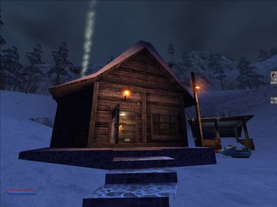

Dege wrote:
Where is lensflare in NOLF?
Could you attach a savegame plz?
Ah, right now I only have the demo, the "Mega Mix Demo" in particular, which reports version number 1.002 (coincides with the 1.002 patch for the full game, I assume).
Actually, after looking at the demo more closely, it's possible that the lens flare effect doesn't necessarily have anything to do with the issue. There are other light sources that have lens flares effects in other levels of the demo where I don't get a framerate hit.
This particular area at the start of Alpine Intrigue Scene 4 does give me a performance hit when looking at the light sources. I learned that the more lights I'm looking at, the greater the performance hit. Looking at one of the lights usually doesn't cause a noticeable hit, but looking at three or more makes the game a slideshow. Also, the light source doesn't have to be visible in the camera, as long as I'm looking towards its direction then I get the performance hit.
207.02 KiB
5589 views
Also, I'm sure my PC's weak hardware, an Intel Q8300 and a Radeon HD 6670, have something to do with it. The performance hit is probably unnoticeable with higher end systems.
Here's my save folder anyway, could be compatible with the full game after all.
Save.zip
271.71 KiB
370 downloads

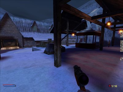

EDIT: Disabling lightmaps gets rid of the performance hit. I think it's only the particular light sources whose lightmaps can change (dimmed when the lights are out) that are giving me the framerate hit. The lights inside the cabin can be switched off and they're the ones tanking my framerate. The game runs smoothly on any other area with any amount of lights as long as those lights can't be turned off. For example, this area later in the level has a lot of lights, none of which can be turned off, and the game runs smoothly here.
