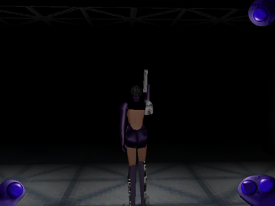

Got a bug report for another crap game: Pax Corpus. Tested using current WIP version. I can't test this on any old hardware, but I don't believe it's rendering correctly. Except for some instability the game seems to work okay in accelerated D3D mode (it crashes in software mode) except that the draw distance is about two inches in front of the character. It doesn't really work natively on Windows 10.
Ok, thanks!

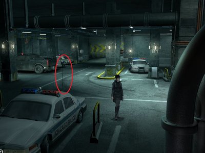

Reply 3034 of 3949, by kevsmudge
Thanks, just wish there was a better way to upscale the backgrounds and hud text, anything other than force point sampled creates tiling / seam lines, same with msaa at 2x or above, the game does have it's own on/off anti-aliasing menu option.
In-game v-sync should be 60fps I think but sometimes it dips below it like on the robot spider laser puzzle going down to 30fps,
mostly in-game it runs at 60-90fps for me ands shoots up to 300fps on menus and video, radtools states the videos as 25fps.
Good news is the junkward reflection bug isn't there with dgvoodoo but the office carpark one remains.
246.31 KiB
3314 views
Edit: Just checked CIN16205-01.bik fmv and it's not a bug in the office carpark it's just a massive car aerial.
