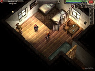

Reply 3213 of 3949, by ZellSF
Xanadu Next from GoG works fine in dgVoodoo 2.54 on Windows 10 for me:
70.87 KiB
2153 views
You need to remove the 256 color compatibility mode forced by GoG's installer though. I just removed the key from HKLM\SOFTWARE\Microsoft\Windows NT\CurrentVersion\AppCompatFlags\Layers then removed the flag in the compatibility tab of XANADU.exe.
Reply 3214 of 3949, by masterotaku
Yes! That was what I needed. Thank you very much. I didn't know GOG was installing that. In that same regedit folder there was a Windows XP compatibility flag for Rogue Squadron, so I solved it too for that game.
