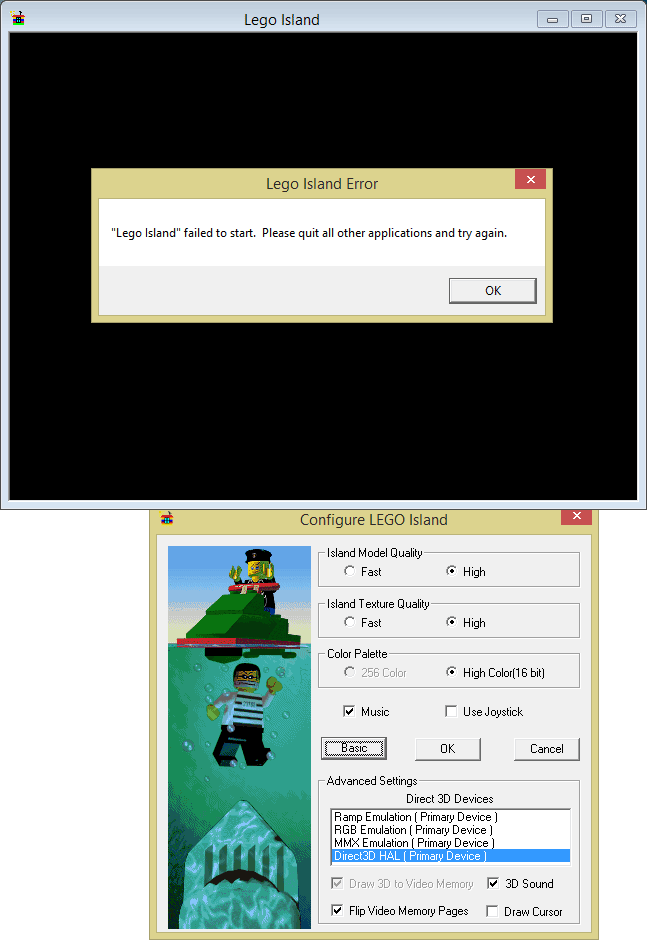

Bad news for Lego Island (uses managed direct 3d, d3drm.dll), game won't start with the dll's in the game folder (config.exe runs but doesn't list dgVoodoo). I'm pretty sure the game pulls the list of Direct 3D devices from the registry.
24.58 KiB
5253 views
Lego Island attempt with ddraw.dll and D3Dlmm.dll installed.
