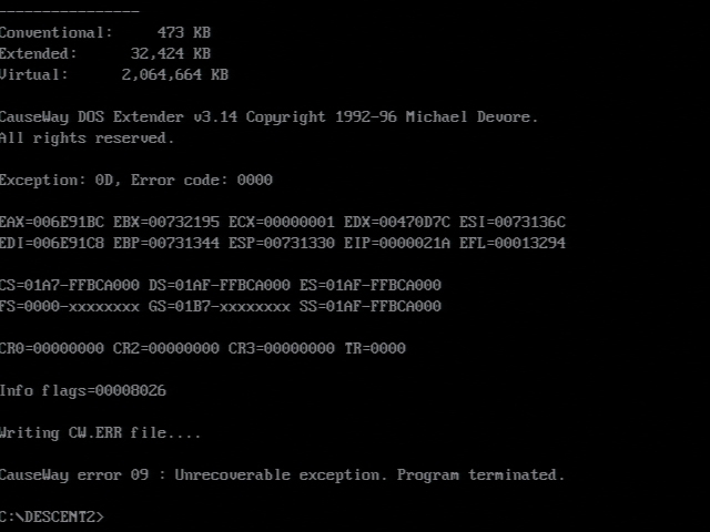

I've tried on three different machines. I get the same error as seen in the attached screenshot. This happens on three different systems. One Socket 7 430TX, one Socket 7 MVP3 and one Slot 1 440BX. DOS version 7 installed on all computers.
I try running it with s3drun with the cards. The game does run with the S3 Virge 325, VX and DX (with S3DRUN). I've tried without autoexec.bat and sound loaded, but to no avail.
I don't own the GX and the original MX so can't test it with those.
My only conclusion so far is that the game is not compatible with S3 Virge MX+ and GX2 in S3D mode even with S3DRUN.

Looks like a segmentation fault (exception 0D). I got similar errors with my Virge DX when trying to start the S3D version of Descent 2. However, these were page faults (exception 0E), at least I think so. I had to replace the DOS extender bound to the d2virge.exe with DOS32/A in order to get it working.
Just a wild guess, as you're getting a different error code, but it might be worth a try...

I troubleshooted some more and I just downloaded the S3DRUN version from your website and the game now works if I run it from Windows. Apparently I was using an old version of S3DRUN.

Hehe, yes, sorry a bit late on this project. I was planning on using recorded demos for playback on the different cards like I did on Descent 1. That would mean I would only need to play the first levels once and than replay the demo with the different cards to get enough gameplay footage . With Descent II, replaying a recorded demo from another version causes very annoying jiggering! This means that I have to play while recording. Since I plan on having splitscreens and transisitons I need to play almost exactly every playthrough. Time consuming and boring.

Is this the same version that's on Vogonsdrivers now? I just downloaded it and got the same error message that you did in the first post.
Trying to run D2 on a Toshiba Tecra 550CDT with a Virge MX for video.

I also struggled with the Virge /DX card I got, looks like it the s3dsrvr and s3drun do not work in regular, plain old MS-DOS? Installing Windows 95 and running it from the DOS window worked! https://www.youtube.com/watch?v=-djkOUvnRTg
