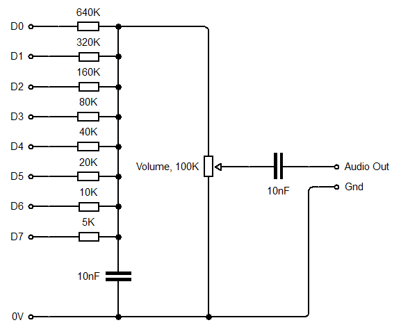

So I consulted with a few friends (two of them are very good electrical engineers) and here's what I found out:
The noise in covox comes from +5V on the mainboard, where almost everything receives power, including the LPT.
The ways to compensate this are to add capacitors (changes the sound as well) or to draw power elsewhere. The second choice is better, that's where chip DACs come to play.
So basically, as long as you pick the right resistors, you get the most 'righteous' sound, you can add capacitors to make it sound smoother but less original, or you can use chips with external power to make most noise go away. Getting a better PSU and motherboard/controller might fix the problem if the noise is too loud.

@snorg 1/4 is fine. 1/8 should also do the job, the signals aren't that strong.
Any resistor type works. Tighter tolerance is better of couse, as it resulsts in cleaner sound.
I tried the first scheme with the caps, btw. The 10uF cap (vs 100nF) is also a good idea, since it has a bit of a low-pass effect (->harmonics).
If you want to "upgrade" later on, you can also make a covox plug with an real DAC (8bit type) or a Stereo-Covox. ^^

Hello, I've found another schematic. This one is simpler to wire and needs less space (improvise R values if needed).
The potentiometer is for volume control and optional. It is close to Stojke's last but one scheme on page 1.
