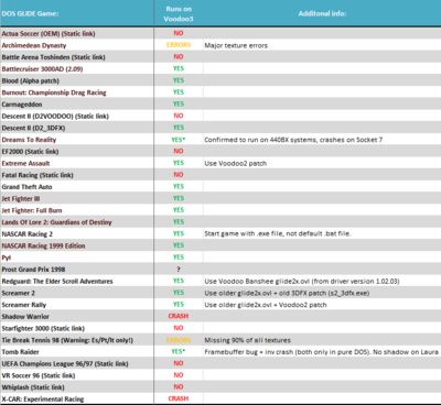

Current Voodoo 3 test results (NOT FINAL!):
41.25 KiB
5734 views
Reply 35 of 355, by vetz
robertmo wrote:
I am sure it was working (on PIII450) as i was trying to figure out reason for blinking text. (too fast cpu btw).
Got Dreams to Reality working as well on my 440BX system. Really strange that it crashes on all my Socket 7 systems, but works on this system.
I guess it can be updated as running, but with a comment that it is very picky about the system.
